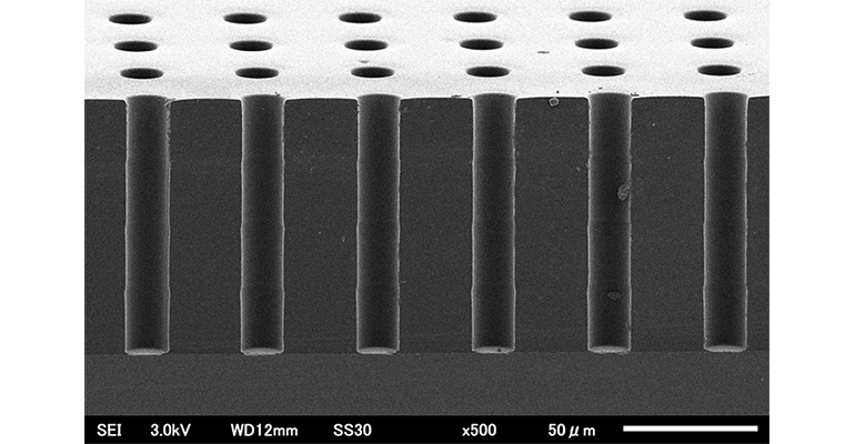

vias
The negative photosensitive polyimide material is 100 micrometers thick with vias measuring 10 micrometers in diameter.Image: Toray
A negative photosensitive polyimide developed by Toray Industries maintains the characteristic thermal resistance, mechanical properties, and adhesion of the material while increasing resolutions and enabling high-definition pattern formation on 100-micrometer and other thick films.

Toray’s new negative photosensitive polyimide material is 100 micrometers thick with vias measuring 10 micrometers in diameter. The company leveraged its expertise in functional polyimide design technology to enhance light transmittance and control photo reactions to achieve this breakthrough.
