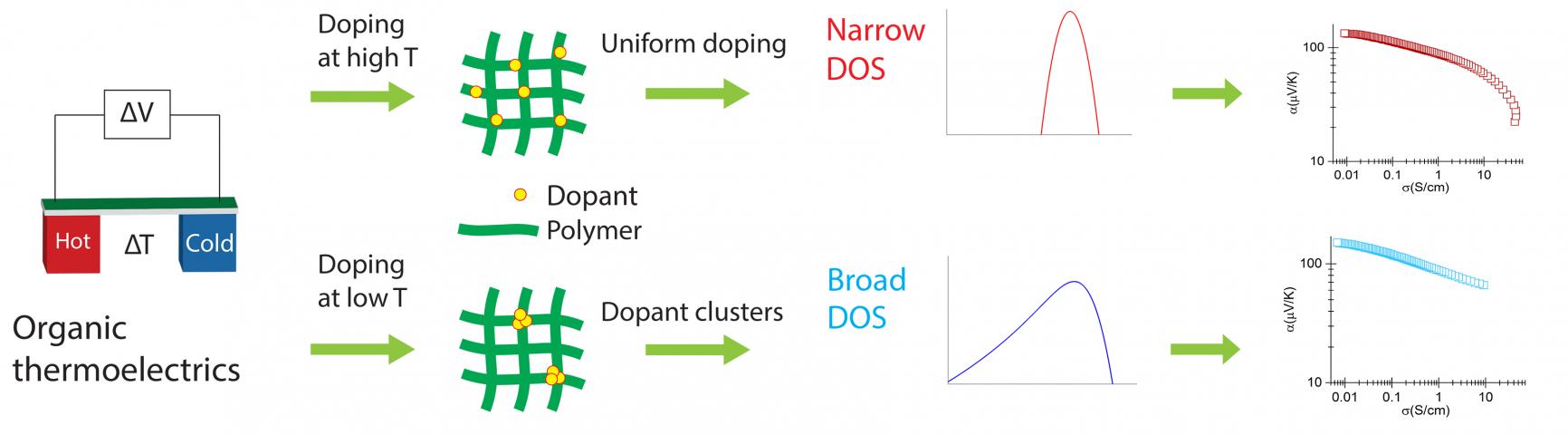

A team of chemists and electrical engineers at the University of Massachusetts (UMass) Amherst have outlined a new way to advance a more efficient, cheaper, polymer-based harvest of heat energy to produce electricity. (Image source: UMass Amherst/Meenakshi Upadhyaya)
Chemist Dhandapani Venkataraman and electrical engineer Zlatan Aksamija have discovered a key variable to making polymer materials conductive—by observing a new characteristic during doping, a process that adds molecules or removes or adds electrons to the polymers to make them conductive.
“As we increase the doping, we can increase its conductivity but decrease the thermally-induced voltage,” Venkataraman explained to Design News about the discovery. “If we decrease the doping, we decrease the conductivity but increase the thermally-induced voltage. We need to balance both.”
What researchers specifically discovered is that dopants can clump, or cluster--or not, he told us. This is key to achieving the right balance for conductivity. “We found that this clustering is an important new variable that we can tune to achieve the balance,” Venkataraman told Design News.
