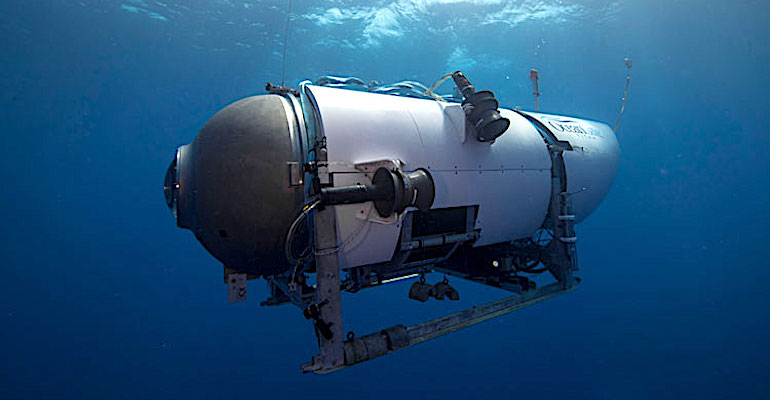

OceanGate Expeditions Titan
The OceanGate Expeditions Titan submersible.OceanGate Expeditions
Following the loss of the OceanGate Expeditions Titan tourist submersible, the company’s use of carbon fiber composite material to construct the sub’s pressure hull has come into question, as the industry standard has been to make them from titanium.

In addition to the possibility of a failure of the carbon fiber hull, Titan’s implosion could have occurred due to a failure at the joint between that hull and the titanium cap that bolted the passengers inside.
“You’ve got two different materials that expand and contract at different rates,” pointed out Hogoboom. “That would be concerning to me, especially since an O-ring seal is part of that assembly.”
