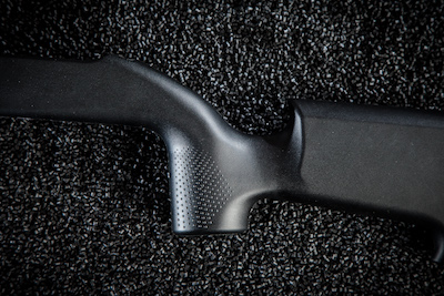

Engineering plastics are playing a role in enhancing the performance of firearms. |

In another example, a new material option substantially improved surface appearance and reduced cycle time and warpage due to molded-in-stress commonly experienced in thick parts such as rifle stocks. Molders often need to run very high mold temperatures to improve resin surface appearance which adversely affects cycle time.
