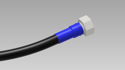

As a first application, the Thermolast K UV/LD/b series grade has been specified for overmolding the interface of co-axial cables and metal connectors, used in outdoor installations at cell towers, with a rugged, UV and moisture resistant boot. |
The new thermoplastic elastomer (TPE) compound was specially engineered to provide significant benefits to OEMs and suppliers within mobile communications infrastructure. As a first application, it has been specified for overmolding the interface of co-axial cables and metal connectors, used in outdoor installations at cell towers, with a rugged, UV and moisture resistant boot.
