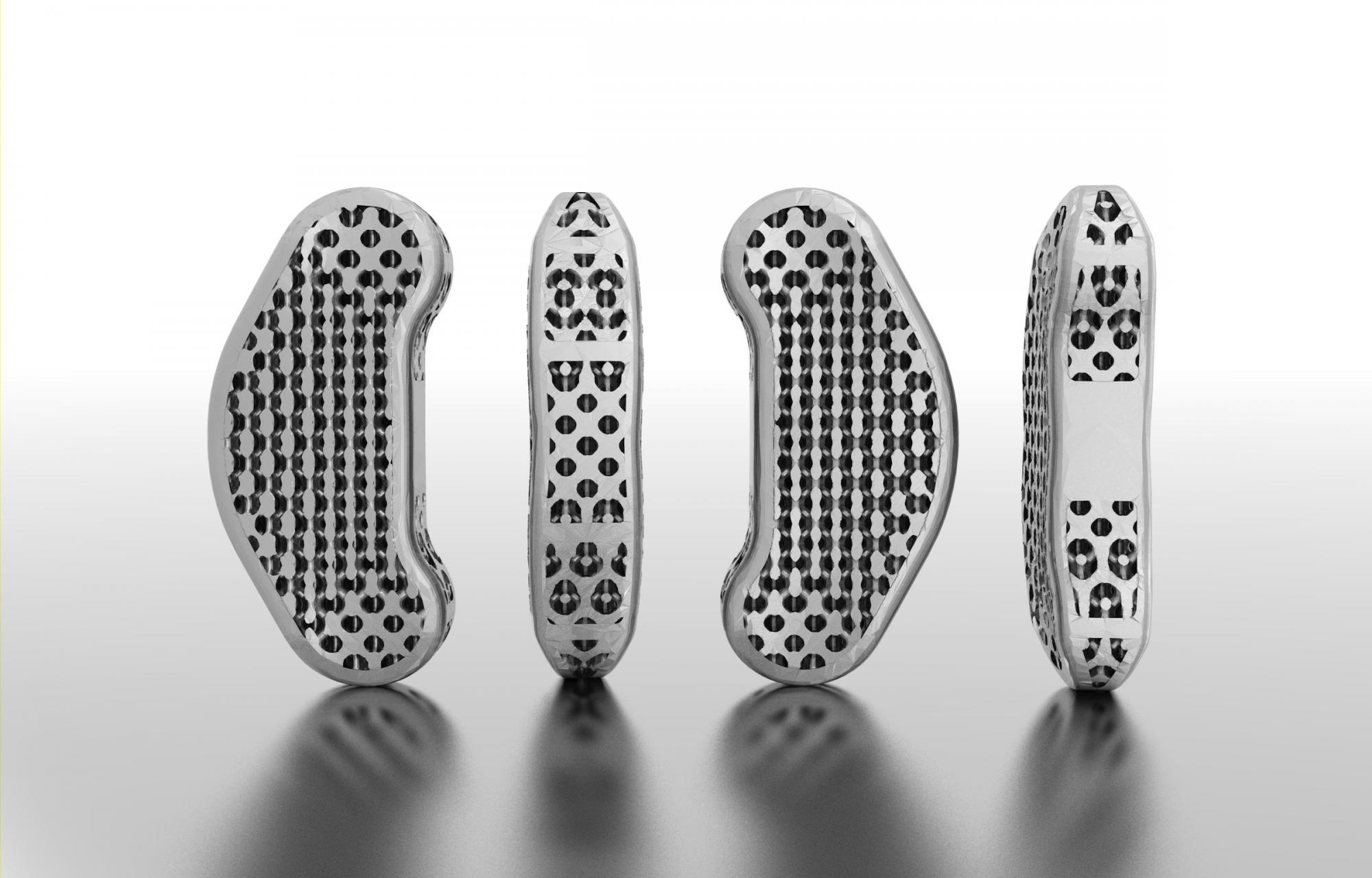

Complex designs are an AM advantage.(EOS)

One specific example noted by Justin is the ability to produce functionally gradient structures that transition from a porous bone in-growth surface to a less porous, more solid load-bearing structure. To produce the same part with subtractive manufacturing, a porous coating is required.
