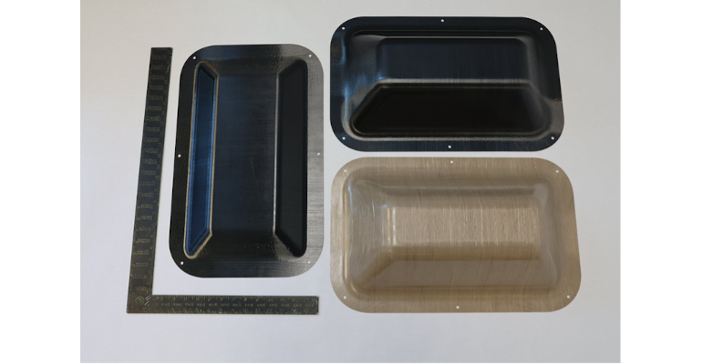

High-strength enclosures can be produced from unidirectional carbon-fiber reinforced thermoplastic composite tape as well as from glass fiber, PAEK, PEEK, and PEI.Image courtesy of Tri-Mack Plastics Manufacturing Corp.
Tri-Mack Plastics Manufacturing Corp. has developed a new process for producing very lightweight, high-strength enclosures using just eight plies of unidirectional carbon-fiber reinforced thermoplastic composite (TPC) tape that measure only 0.040-in. thick. Introduced at last month’s CAMX show, the enclosures were made using Tri-Mack’s process of automated tape laying, consolidation, and stamp forming, which can produce parts in minutes, rather than the hours that are typically required for thermosets, the company shared in a news release.
