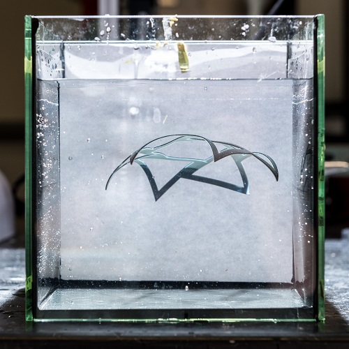

An object printed with a new 3D-printing method that allows for permanent shape shifting in response to heat. A cross-institutional team of researchers from three universities has developed the method, which has applications for biomedical devices, toys, robots, as well as others. (Source: Georgia Institute of Technology)
