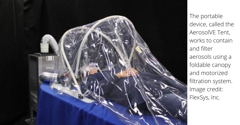

Michigan researchers and engineers have introduced a portable negative pressure tent that could have a very positive impact on hospitals overwhelmed by COVID-19 cases.
Michigan Medicine researchers designed the negative pressure tent, which recently received emergency use authorization from FDA. The portable device, called the AerosolVE Tent, works to contain and filter aerosols using a foldable canopy and motorized filtration system. It was developed by the Michigan Center for Integrative Research in Critical Care (MCIRCC) in collaboration with FlexSys, a Michigan-based mechanical systems engineering company. FlexSys has formed InspireRx, a Michigan Medicine spinoff company, to bring the product to the market.

"The device can turn any hospital bed, stretcher, or operating room into a portable negative pressure room," Haas said. "The light weight, collapsibility and inexpensive materials also make it ideal for use in non-traditional settings such as field hospitals.”
In clinical testing, doctors performed tracheostomies on three intubated COVID-19 patients while using the negative pressure tent. Tents were also used on 20 emergency department patients, either with unknown COVID status or known to be COVID positive, for several procedures, including endotracheal intubations, with 100% first-pass success, high-flow nasal cannula, non-invasive ventilation and electrocardiograms. It generated up to 600 air exchanges per hour, of which only 12 are required by the Centers for Disease Control and Prevention for negative pressure rooms.
