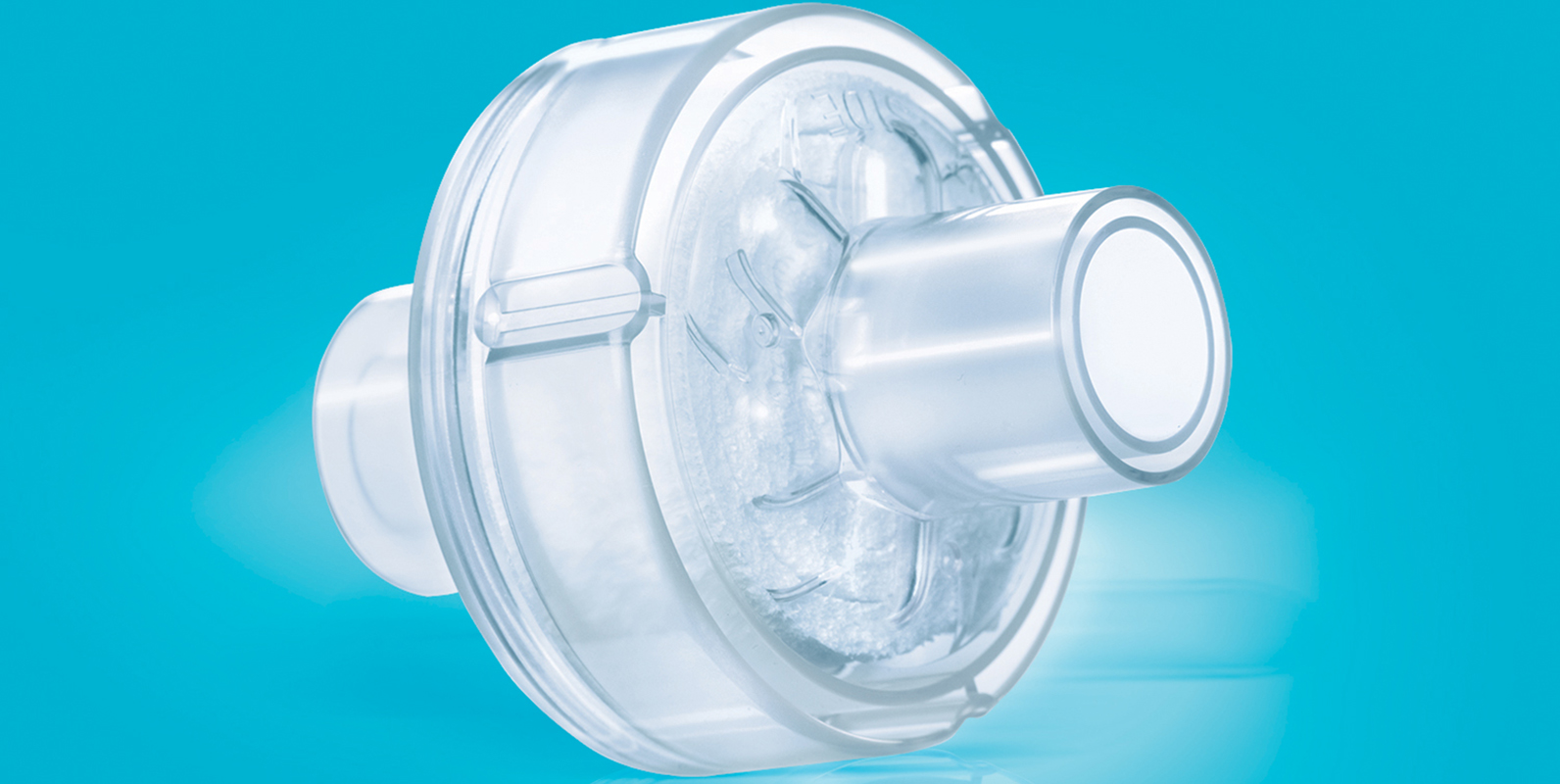

Thanks to operating cylinder temperatures ranging from 210° to 260°C, Toyolac provides smoother resin flow and increased cycle times with decreased part flash, said Toray. This enhanced flowability allows for increased part cavitation and improves the molding of thin-walled part features. It also reduces tooling wear and contributes to a longer mold life, said Toray. To illustrate the material’s benefits, Toray cites heat and moisture exchangers (HMEs) molded with Toyolac resin.
The HME parts bond together easily by means of adhesives, said Toray, and they withstand exposure to lipids, alcohol, and cleaning agents. The material imparts strength and stiffness across the molded components. The scratch-resistant molded surface is also printable for tracking and identification purposes as well as brand identification.
