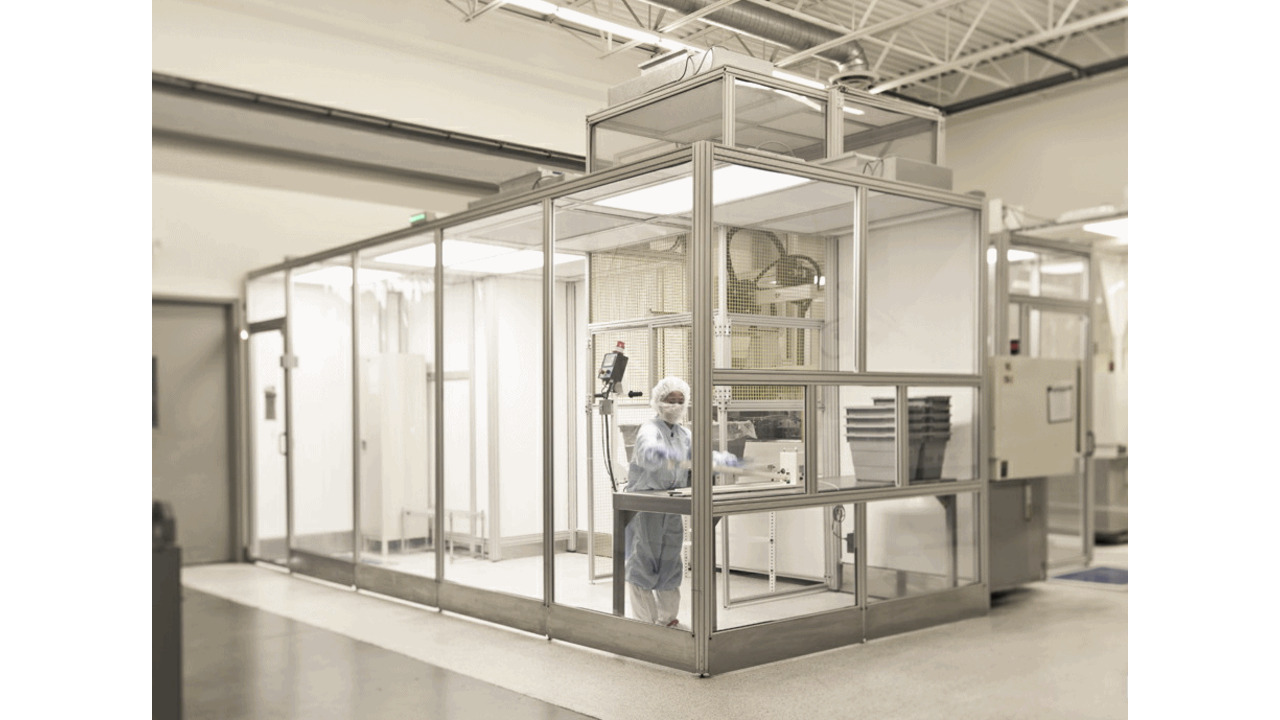

 ADCF molding room (AMT).

Jenkins also said that AMT is one of three molders in North America that has an Animal Derived Component Free (ADCF) cleanroom. The trend emerged to ACDF in recent years due to concerns about bovine spongiform encephalopathy (BSE), commonly known as mad cow disease. Some release agents historially used bone tallow as a lubricating material.
Several resin producers now offer grades of plastics that are "animal free". The ADCF cell also requires that
High-volume automated assembly cell (AMT).
the resin and molded component do not come in contact with any non-ADCF plastic items such as bags, hoses, and tubs.
Prior to development of the ADCF manufacturing cell, it was necessary to wash purchased molded components prior to use in downstream processes. Some OEM designs now specify a "no wash" requirement.
