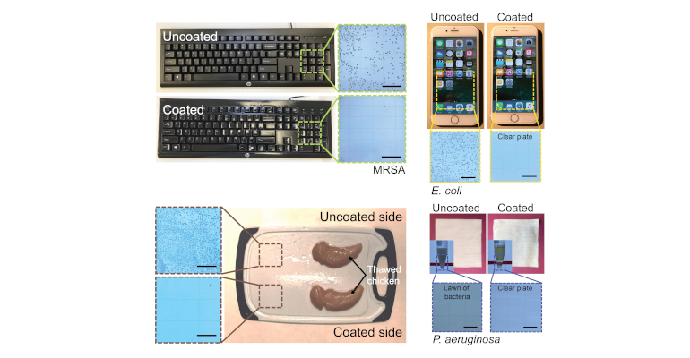

These images show the bacterial load on a coated and uncoated computer keyboard, cell phone, and cutting board with raw chicken. Image courtesy of Anish Tuteja, University of Michigan
