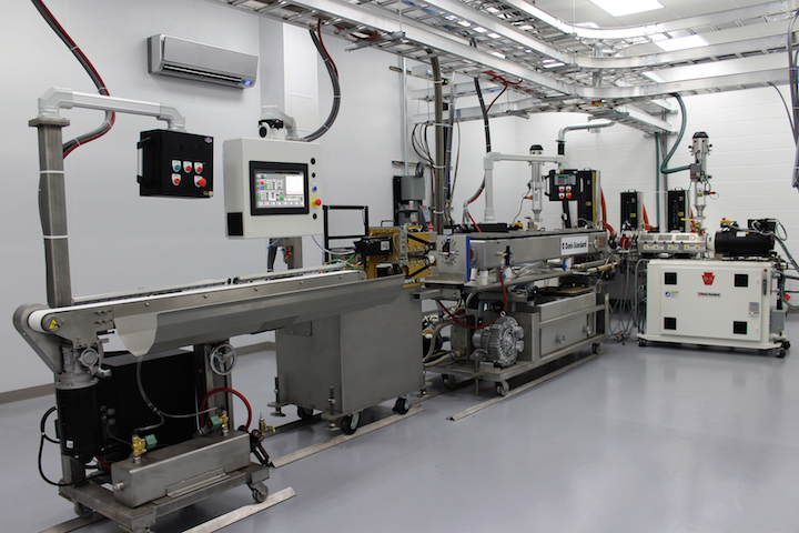

FEP tubing with barium sulfite stripes ran on the medical tubing lab line, followed by alternate polymer tubing. The line with two MEDD (Medical Extruder Direct Drive) extruders and associated downstream equipment is located in a climate-controlled cleanroom environment. Customers are able to test new resins, make parts for proof-of-concept and conduct downstream R&D prior to making large capital equipment investments. The line is extremely versatile, adds Davis-Standard, and is set up to run multiple resins. It also incorporates Davis-Standard's patented alternate polymer technology with all components monitored and controlled by the EPIC III control system.
