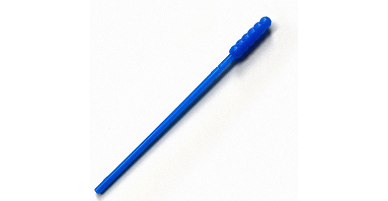

It’s safe to say that few people gave much thought to nasal swab design and manufacture until COVID-19 came to town. As we lined up for tests, though, suddenly everyone had an opinion about the long-stemmed scrapers. There were questions about efficacy, and discomfort was a common complaint. Oh, and there were worries that a shortage of swabs might be on the horizon. A couple of recent innovations have helped to allay those concerns.
Today, Technimark announced that it has partnered with Rhinostics and iMFLUX to produce, package, and distribute individually packaged nasal swabs to help detect and diagnose potential infections such as COVID-19. Production of the medical-grade polypropylene swabs began in April at Technimark’s headquarters in Asheboro, NC, where the swabs are injection molded and packaged in an ISO Class 8 cleanroom and sterilized prior to distribution.

The injection-molded polypropylene nasal swab was developed by P&G and iMFLUX, a subsidiary of P&G that offers low-constant-pressure injection molding software invented by P&G. Rhinostics has the license to bring the swab to the clinical laboratory market. The novel swab allows for easy collection from the front of the nose, reducing patient discomfort, and reportedly absorbs up to a 30-fold increase in sample concentration compared with conventional swabs.

Meanwhile, informed by almost seven years of 3D printing research at MIT’s Media Lab, Jifei Ou, PhD, developed a new type of nasal swab for COVID-19 testing. Since March 2020, he has been working with hospitals to improve the design of swabs by applying thin, hair-like structures that Ou developed while at MIT. Tiny woven lattices within the swabs allow them to absorb and release more fluid than conventional swabs, said the release on the MIT website.
Ou’s spinout company, OPT Industries, uses a continuous manufacturing approach that allows it to scale up 3D-printer production to meet demand. To date, it has supplied more than 800,000 swabs to healthcare and at-home testing organizations, helping to meet a shortage that had threatened hospitals’ testing capacity.

OPT’s products are designed using algorithms that attempt to optimize each fiber placement. The company’s swabs feature porous microstructures within their heads that are tuned to collect and retain fluid, then quickly release that fluid when it enters a test vial.
“When it came to the swabs, we thought, ‘Hey, that’s a great fit!’” Ou recalls. “Swabs need to be soft, flexible, the structures on the tip need to be very intricate. That’s what we do,” he told Winn.
Tests conducted at MIT and an external microbiology lab comparing OPT’s swabs with traditional cotton swabs showed that OPT’s swabs released 20 times the amount of bacteria for testing.
