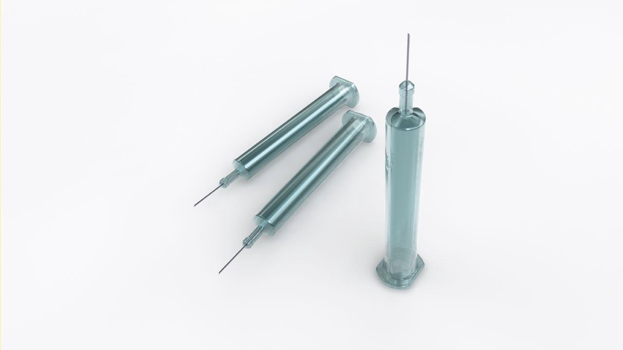

Drug delivery systems.  These include needle free injections, and transdermal systems. A new low-cost option to stop needle-stick injuries made of acetal copolymer was shown at K2013 in Düsseldorf, Germany last month.
