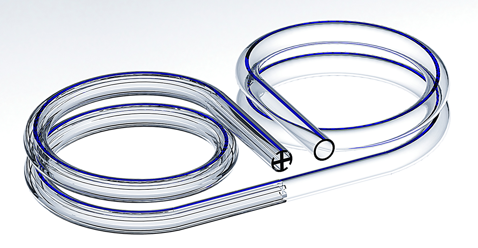

Reciprocating head automatically changes tubing profile in single extrusion run
Guill Tool, at booth 1736, will showcase a reciprocating head that, the company says, has proven especially popular with customers. By replacing the traditional tip and die assembly with a linear reciprocating head, the tube’s profile can be changed within a given length. This process is repeated interruption-free throughout a single extrusion run. Cutting capability, in association with the extrusion speed, cuts the finished product to length, said Guill.
The technology improves product quality while reducing cost, according to the company. Only one extrusion run is needed as opposed to multiple runs with tooling changes and manual assembly to connect different tubing shapes.
Guill’s new reciprocating head also eliminates in-process inventory because there is no need to store various tubing shapes and connectors needed for assembly.
