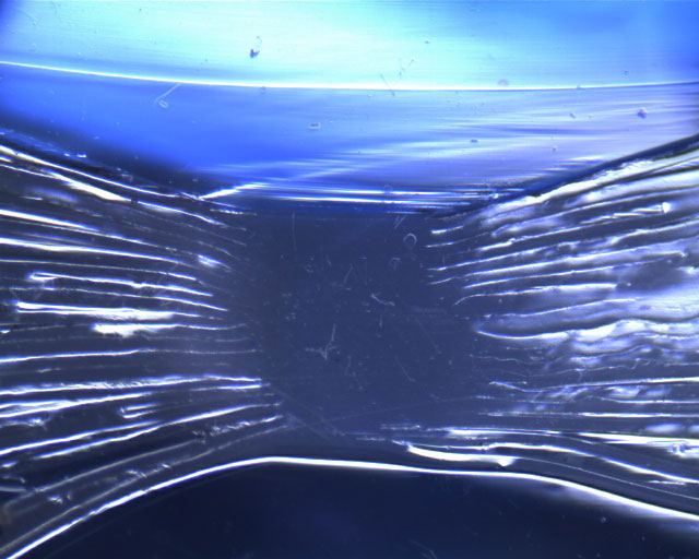

The melt zone is visible in 20 layers of 0.1-mm-thick LDPE welded with 90 watts of laser power at 1940 nm. Source: IPG Photonics

IPG Photonics is targeting plastics welding for medical devices with thulium fiber laser systems that operate in the spectral range of 1800 to 2100 nm. A 1940-nm system was demonstrated at NPE2012.
"At this wave length you get more absorption in almost all clear polymers because the wavelength is closer to some vibration frequencies of the carbon-hydrogen bond (in plastics)," Hoult said in the interview. "When you bond polymers, you want something between 0 and 100% absorption and that's what you get with the thulium fiber laser."

One of the benefits to this welding technique is that no material modifications or additional infra-red
absorbing layers are necessary to improve the absorption of the laser beam in the polymer. The reason is that the absorption of the laser beam is taking place in the bulk of the polymer, not just at the surface or at the interface.
