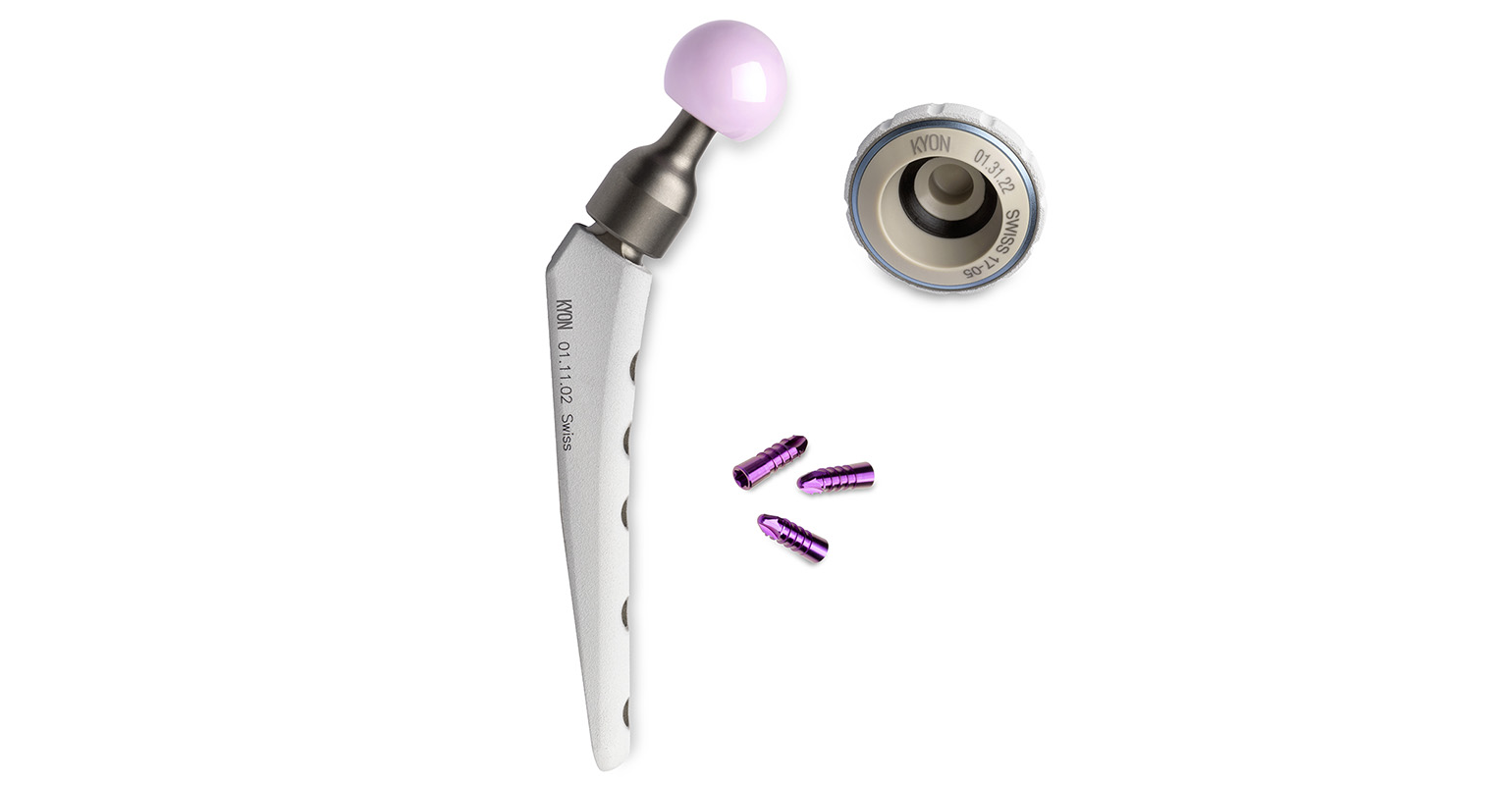

Image: Kyon/Evonik
More than 6,000 PEEK-based cement-less hip prosthetics developed by Swiss company Kyon have been implanted successfully in dogs and cats without requiring any revision surgery to date. A carbon-fiber-reinforced PEEK inlay between the ceramic head and cup, fabricated from Evonik's VESTAKEEP material, is at the heart of the technology. Now, Evonik is partnering with medical specialists at the Center for Knee and Hip Replacement at Massachusetts General Hospital (Mass General) in Boston to test the technology for complex joint prosthetics in humans. The research could significantly extend the service life of these implants.
Inlays, or friction partners, between the head and cup of a hip implant anchored to the bone are a weak link in conventional hip implants, according to Evonik. By using a ceramic-on-PEEK construction, “linear wear is reduced by a factor of seven compared to conventional pairings, which is why we have based our latest generation of hip prostheses [for pets] on this material combination," explained Guy C. Spörri, CEO of Kyon.
