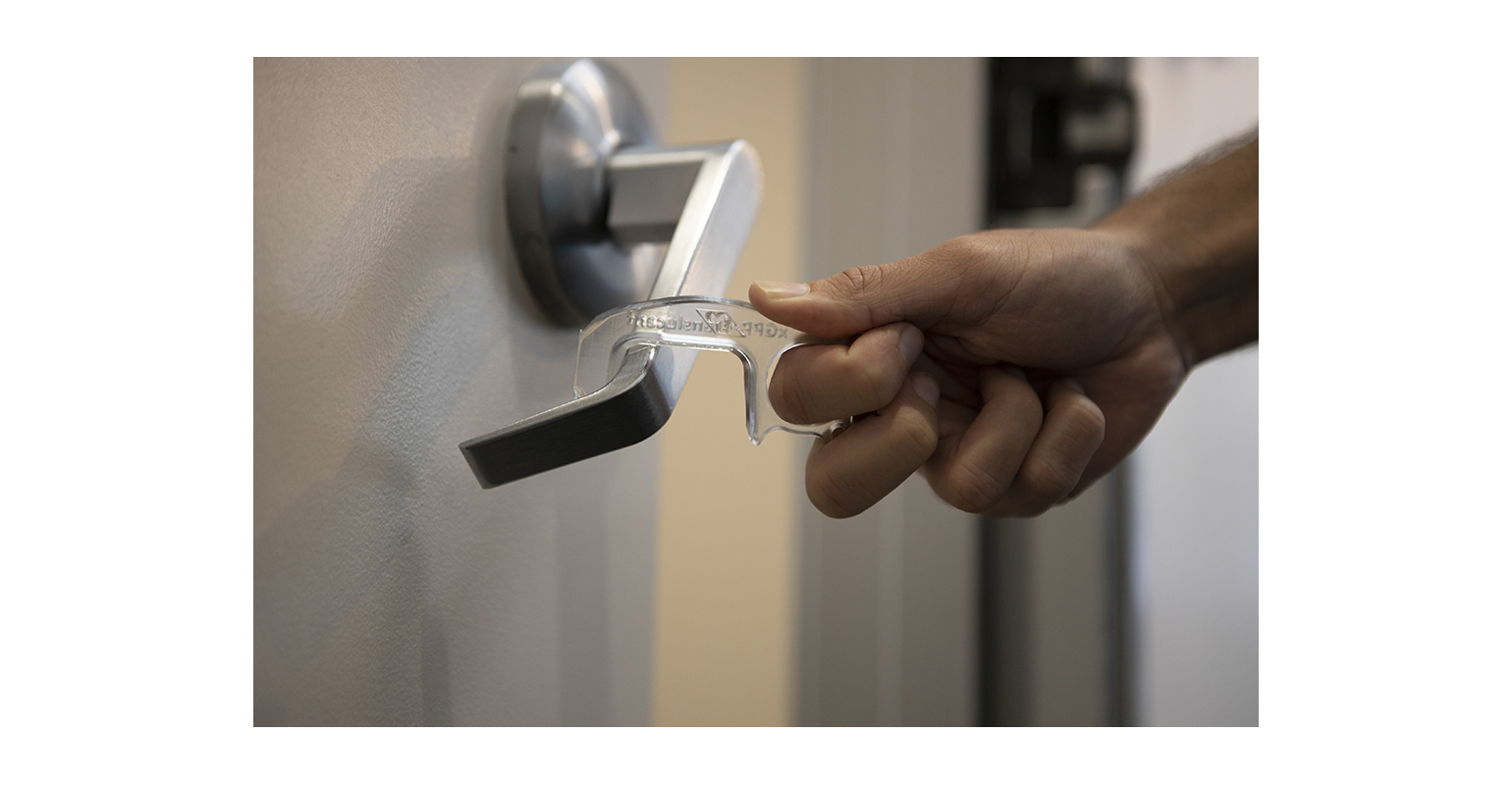

3D-printed door opener
3D-printed hands-free door openers help prevent the spread of infections. Image courtesy Henkel.
