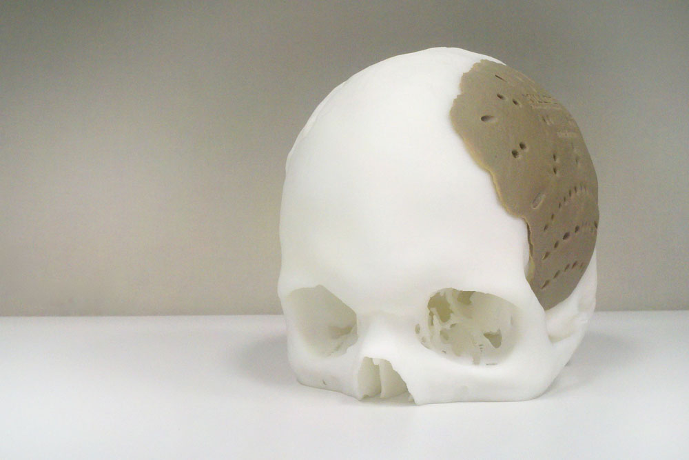

OsteoFab implant made with PEKK.
Those with severe head wounds could be treated with cranial implants made with polyetheretherketone (PEEK) or one of its close chemical cousins. Those with amputated limbs or feet could use new high-tech prosthetics often made with carbon composites or reinforced engineering thermoplastics that provide toughness and strength.
Pioneering work with custom-fitted cranial implants for wounded soldiers was done at Walter Reed Army Medical Center (WRAMC) in Washington, D.C. The custom implants made with additive manufacturing (3-D printing) technology cut surgical times by more than 50%.
"The time savings can be directly attributed to the improved implant design and attached fixation," said Stephen L. Rouse, DDS, a government contractor working in the 3-D Medical Applications Lab at Walter Reed Army Medical Center. "Large implants were previously multi-piece constructs, and were slower to place and fixate."
WRAMC surgeons used titanium powder that was laser sintered into the shape of the missing skull bone.
Since then there has been increasing use of ketone polymers that are either machined or also made with selective laser sintering machines.
One example of a new technology is "OsteoFab" implants made from polyetherketoneketone (PEKK).  Oxford Performance Materials (South Windsor, CT) recently received  FDA 510(k) clearance for its OsteoFab Patient Specific Cranial Device (OPSCD). According to the company, it is the first approval for an additively manufactured polymer implant.
