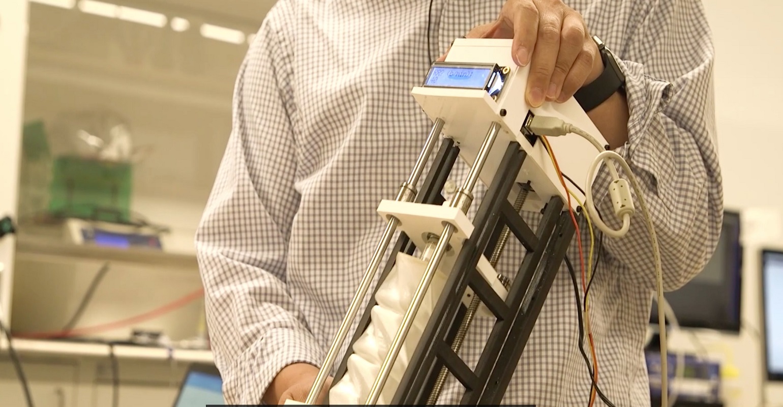

A team of scientists at Simon Fraser University (SFU) in British Columbia has used inspiration from the Japanese art of origami to develop a portable ventilator that can be 3D-printed.
The solution could help meet the demand for ventilators prompted by the COVID-19 pandemic as well as provide low-cost technology for remote areas of the world or those with limited resources.
The work, led by SFU School of Mechatronic Systems Engineering’s associate professor Woo Soo Kim, uses an intelligent 3D-printed origami tube to drive a low-cost ventilator, presenting an alternative to how typical ventilators work that lowers both its size and its cost, he said.
The portable ventilator assists a person’s breathing by contracting the origami tube rather than compressing a conventional bag-valve-mask (BVM) found in conventional ventilators used in hospitals. Yet it still can work effectively to provide oxygen to patients who need it.
“The active airbag's volume can be tuned by controlling the triangular angles in the 3D origami-folding plates,” researchers wrote in a a paper on their work in the journal Flexible and Printed Electronics. “Moreover, its volumetric ratio before and after compression is around 85%.”
Device Benefits and Uses
Another benefit of the device is that the way the 3D origami tube rotates under the compressive force provides advanced functionality. This includes architectured pressure sensing, which confirms the accuracy of detected pressure in the ventilator circuit, they observed.
“We achieved accurate delivery of targeted air volume with specific airflow rate by 3D printed reconfigurable origami tubes,” said researchers in a statement.
The team also used lightweight materials combined with fabrication by additive manufacturing to lower the device’s production cost significantly, Kim said.
“In our portable origami ventilator, more than 95% of components can be 3D-printable, that’s why it is really cost-efficient,” he said in a press statement. “Other portable ventilators can cost over $2,000, but our 3D-printed ventilator can be produced for about $200.”
