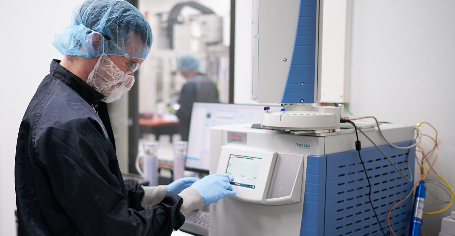

engineer performs material characterization test
MTD Micro Molding engineer Patrick Haney performs material characterization test.Image: MTD Micromolding

In MTD’s work molding implantable micro parts, validating criteria for success means “we monitor things like intrinsic viscosity and residual monomer content,” Haney said, “so a resin’s molecular homogeneity is critical for MTD to develop robust process windows. When we partner with material suppliers, we challenge them to meet tighter molecular weight distributions from lot to lot as well as to hold a higher standard for material homogeneity.”
