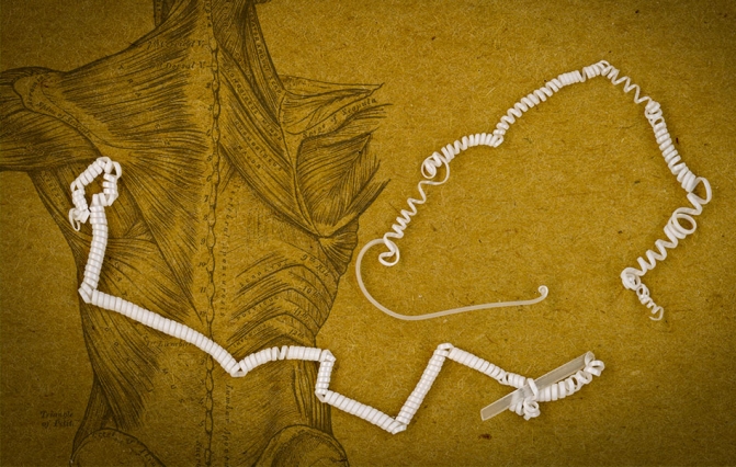

The tiny coils in the fiber developed by MIT researchers curl even tighter when warmed up. This causes the fiber to contract, much like a muscle fiber. (Image sources: Felice Frankel, MIT News)
