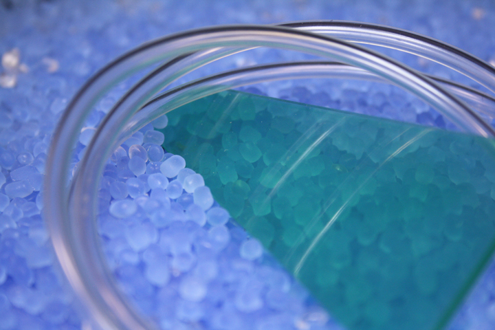

Elasto has developed TPE compounds for medical applications that combine transparency and vibrant colors.

Elasto took advantage of the Fakuma platform to present its portfolio of colored, transparent TPE compounds. The Mediprene materials offer crystal-clear transparency with the addition of color for product identification purposes and branding. The use of blue or green coloration is also beneficial to offset the yellowing that occurs in medical devices undergoing gamma sterilization.
Mediprene compounds are made only from medical-grade raw materials, and the color masterbatches comply with USP Class VI guidelines or ISO 10993 standards, as applicable, and are manufactured under rigorous traceability and consistency controls. Quality systems comply with ISO 13485, the international quality standard for medical manufacturing. The compounds are available in 30 to 90 Shore A hardnesses in 5 Shore A increments.
