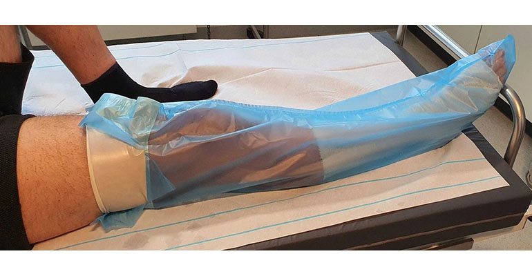

Thermoplastic elastomer (TPE) compounder United Soft Plastics Inc. has developed a custom extruded TPE film for wound-healing applications. The medical-grade TPE developed in conjunction with a Danish startup improves patient comfort while providing wound protection, according to United Soft Plastics (USP).
The area in proximity to wound dressings must be kept clean and dry before follow-up treatments or daily aftercare and protected from bacterial exposure. This is typically accomplished by covering the wound dressing with a medically protective film or protective bag (polybag), which is then affixed to the skin with an adhesive tape and sealed. Tearing off the tape to remove the protective film may subject the patient to pain in connection with micro-injuries to the topmost skin layer.
The custom medical-grade TPE, sold under the brand name Impervious, eliminates patient irritation and pain, said USP. The latex-free material does not have to be torn off because it is permanently welded to the polybag as a stretchable, flexible, and conical sealing strip. Adhesive tape is not used in this construction.
