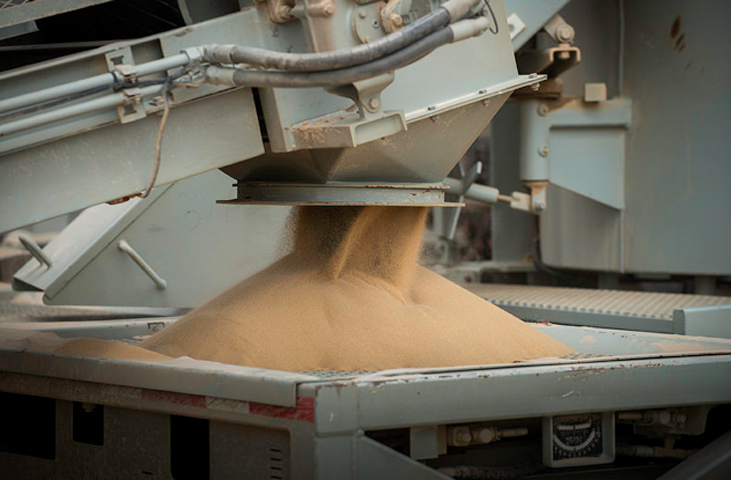

Photo courtesy Tom Payne/AP Statoil.
Bioastra developed composite particles that swell up to 10 times their initial size in liquid, notes a news release distributed by challenge organizers. The beads are lightweight, extremely strong and much smaller in size than other proppants—industry jargon for the materials used to "prop open" the fractures. Similar to a material initially developed for artificial cartilage and occlusion agents for surgery, the particles can fit into small fissures and conform to small cracks in the formation. They are also more buoyant than sand, facilitating better suspension in fluid.
