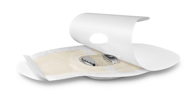

Within a wearable medical device, such as this skin-worn patch, adhesive polymer materials play a role in attaching the device to the patient as well as holding together components.
