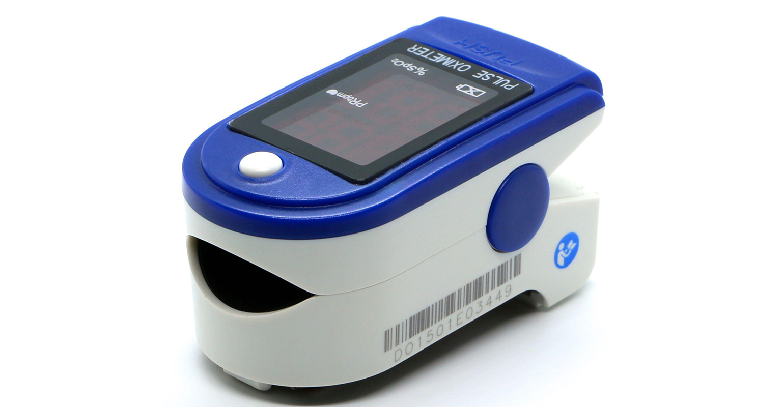

pulse oximeter
Image courtesy of Alamy/Tony ALS
