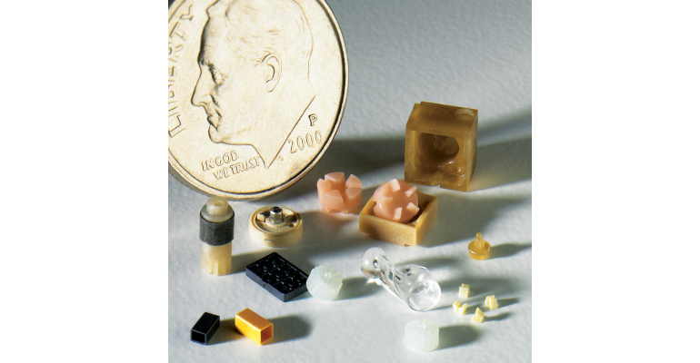

Miniaturization continues to advance medical treatments, consumer electronics, appliances, autos, and much more. Micromolding is helping bring about some of these advances.
“Micromolding is revolutionizing various market sectors by enabling the production of intricate and miniaturized components with exceptional precision and efficiency,” Paul Runyan, VP of Sales, Accumold, told Design News, MD+DI's sister publication. “Industries such as medical devices are at the forefront of benefiting from micromolding innovation. The medical sector relies on micro-molded components for applications like minimally invasive surgical instruments, drug-delivery systems, and implantable devices. The ability to manufacture complex geometries at micro-scale dimensions ensures enhanced patient outcomes, reduced invasiveness, and improved device performance. Additionally, the electronics sector is capitalizing on micromolding for compact and lightweight components used in wearables, sensors, and consumer electronics.
