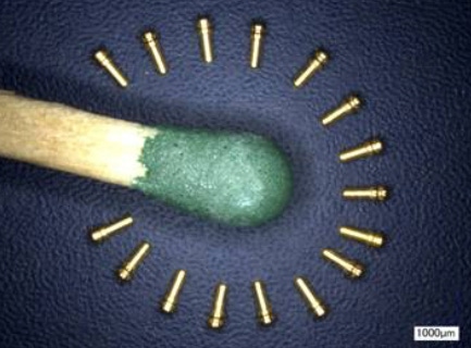

When injection molding and toolmaking company Reiter HG Geiger Kunststofftechnik GmbH (Hilpoltstein, Germany) sought to automate a delicate, precise assembly process, finding a partner proved to be daunting. The operation, which was being done manually, involved the insertion of 0.4-mm-diameter parts measuring 1.65 mm long into slides with injection cavities that are barely larger than the parts. Several companies Reiter approached did not consider their technology up to the task, given the miniaturization of the components and the precision required in their manipulation. It began to seem like the “task was not even solvable,” said Process Engineer Hans Kolb, but perseverance eventually paid off. A mechanical engineering firm partnered with Reiter to develop the right combination of vibratory feeding, vacuum suction and robotics to automate the process.
Contacts, including pins less than 1 mm long, must be placed in a slide for overmolding.
