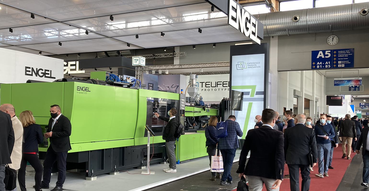

Engel is molding pipette tips on an e-mac 180 at Fakuma. |
Meanwhile, Engel is putting an e-mac 180 through its paces at booth 5204 in hall A5. The machine with an 1,800-ton clamping force is molding pipette tips out of Borealis Boremed polypropylene. Part weight is 19.5 grams. The system includes a 64-cavity mold from Tanner and Engel's own viper 12 robot. Cycle time is 6 seconds.
