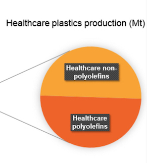

“Only about 1% of the 311 million tons of plastics, or about 3.1 million tons, go into healthcare,” said Petzold. And yet, medical plastics get an awful lot of attention. They punch above their weight because they are subject to “the highest quality requirements and most stringent regulations. Yes, it’s a tiny market,” said Petzold, “but it has been a large focus for Borealis.”
Borealis is one of the largest polyolefin producers in the world, reporting $7.2 billion in sales in 2016. While the medical space is a small part of the company’s overall business, medical applications for polyolefin have been growing over the past few years, according to Petzold. The reason, she added, is because it achieves a desirable balance in performance and cost and enables a breadth of new design opportunities. During the webinar, Petzold highlighted two recent medtech “breakthroughs” that were made possible by Borealis’ medical-grade soft polypropylene, marketed under the Bormed name.
