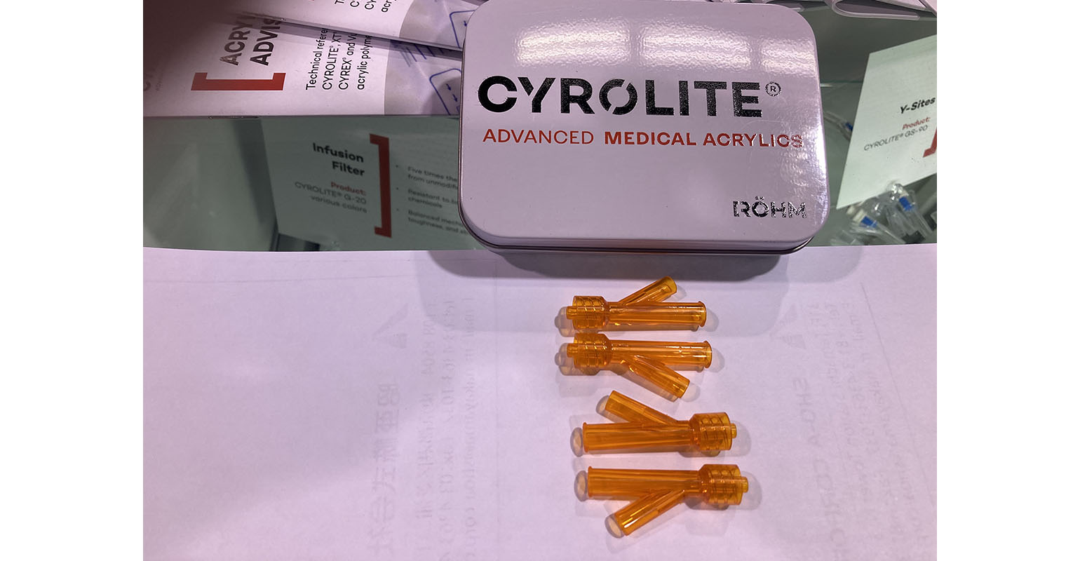

y sites made from Cyrolite acrylic

Cyrolite MD zk6 acrylic polymer is an amorphous, impact-modified thermoplastic injection molding and extrusion compound based on PMMA for the medical device and diagnostics industry. High impact resistance and ductility/toughness make Cyrolite  MD zk6 suited for applications like dialysis cassettes, test packs, filter housings, microfluidics, luers, tube connectors, IV catheter hubs, and Y sites.
The compound has three times the impact resistance of other medical-grade acrylics and features high light transmission with little haze, said Röhm.
