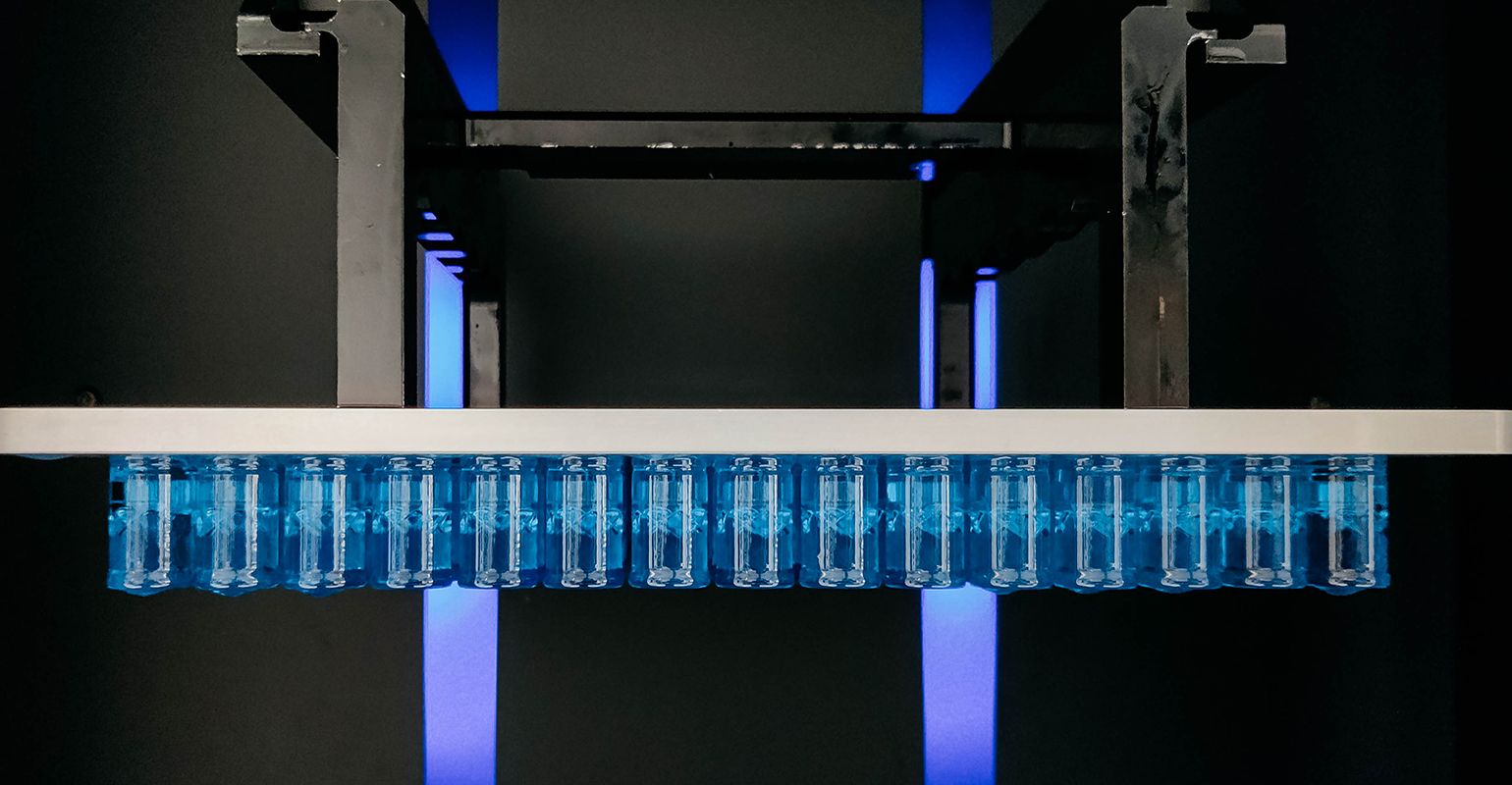

3D-printed injection mold tooling
3D-printed injection mold tooling.
The FIM process begins with high-precision, tight-tolerance, dissolvable tools printed by means of digital light processing. The tools can be used in injection molding machines with injection pressures up 2500 bar and maximum melt temperatures of 842°F (450°C), and are compatible with composites, thermoplastics, thermoplastic elastomers, silicones, ceramics, and metals. Rather than ejecting the component from the tool, as is customary in injection molding, the tool itself dissolves to release the molded part. The demolding takes between 12 and 48 hours.
