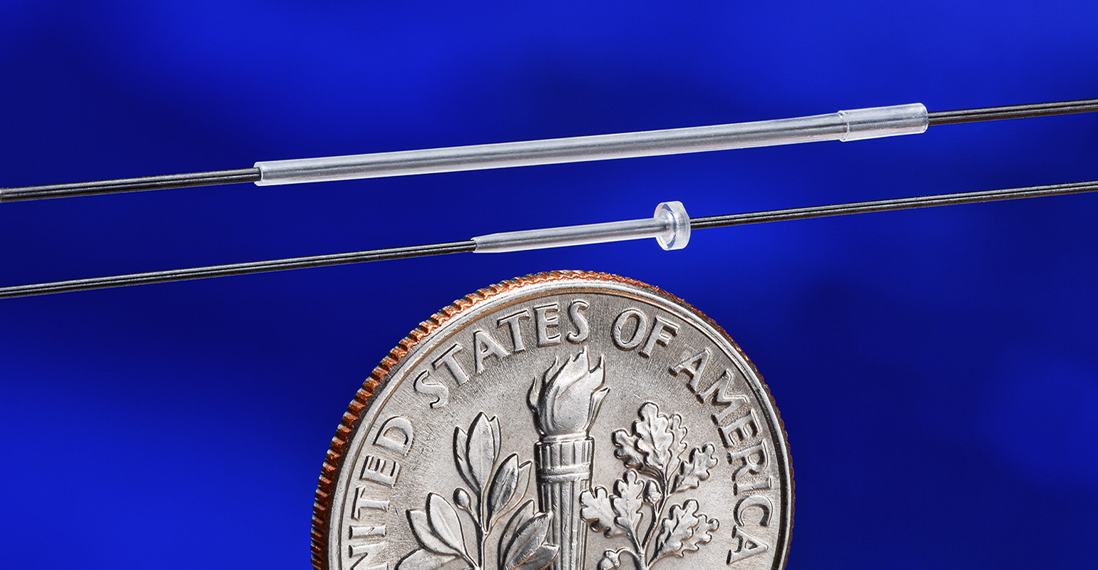

thin-walled micro-molded medical part
Image courtesy of MTD Micro Molding

Patrick Haney: When it comes to achievable thin walls, the answer is, “It depends.” One of the main factors is material choice. Can your design use a thermoplastic material that is better suited for ultra-thin walls, like liquid crystal polymer (LCP)? Or does your part functionality require other material characteristics, like the rigidity of PEEK, which is much more challenging for thin-wall molding? Or does your thin-wall design require multiple materials for an over-molded component?
LCP and PP are known for their thin-wall molding capabilities, having the ability to fill walls of about 0.002 in., depending on geometry. Polyesters and nylons are also great options.
The main benefits of thin-walled medical device components and implants are patient comfort, and the smaller a part can get, the smaller areas it can effectively monitor and treat. Miniaturization can broaden capabilities of these medical devices, and that goes hand in hand with thin-walled designs.
