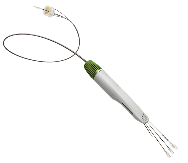

Transcatheter aortic valve replacement (TAVR) surgery, which is typically recommended for patients with severe aortic stenosis who are too ill to undergo open-heart surgery to replace a diseased aortic valve, can cause aortic regurgitation (AR). Also called aortic insufficiency, AR is a leaking of the heart's aortic valve that causes the blood to flow in the wrong direction, which can lead to serious complications. An all-plastic TAVR device developed by Direct Flow Medical (Santa Rosa, CA) may minimize the risk of AR, according to the company, because all of the device's metal parts were replaced with polymer-based materials. Sister brand Qmed spoke with the company's Director of Surgeon Relations, Randolph Chitwood, MD, who explained how material development enabled the design of "the gold standard" in surgical valves.
Direct Flow MedicalChitwood told Qmed that at the outset of the project the company was looking for a material with low viscosity that solidified quickly and was radiopaque. Moreover, it had to be "tolerable for patients" if it accidentally entered the bloodstream and had to be strong and creep resistant in its solid state. Unable to find an existing material that met all of those and other requirements, the company built a lab and assembled a team of device development engineers, material scientists and chemists with expertise in polymers.
"We looked at countless different chemical families and settled on a water-soluble epoxy backbone with an organically bound iodine additive for radiopacity," Chitwood told Qmed. "The real discovery came in finding the right amine blend. This is where . . . we were able to develop something that met all those divergent characteristics."
The polymer frame of the TAVR device is 30 times safer than conventional metal-based frames, contends Chitwood, who adds that this "revolutionary platform" is the "first and only commercial iteration of a polymer TAVR device."
