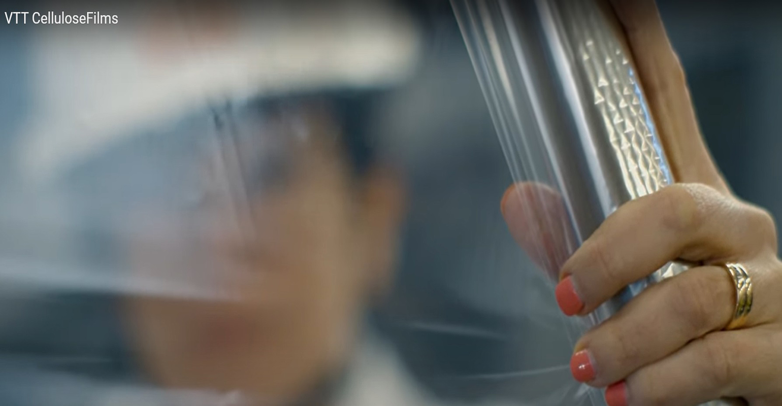

VTT has developed a polymeric solution to address the problem: regenerated or recrystallized cellulose that can replace clear plastic films.
“We can produce transparent and flexible cellulose film,” says Ali Harlin, VTT research professor. “The consumer cannot distinguish between the crystal-clear material and traditional oil-based plastic. Cellulosic film can resist dampness, but in nature it disappears as completely as a sheet of paper does. The product is biobased and biodegradable.”
According to the associated video, the cellulose is sourced from side streams from pulp mills, recycled paper, and recycled clothing. It can be used as a standalone wrap or as an environmentally friendly moisture-resistant coating for paper.
It's claimed as better than traditional cellophane because no harmful chemicals are used in the manufacturing process.
