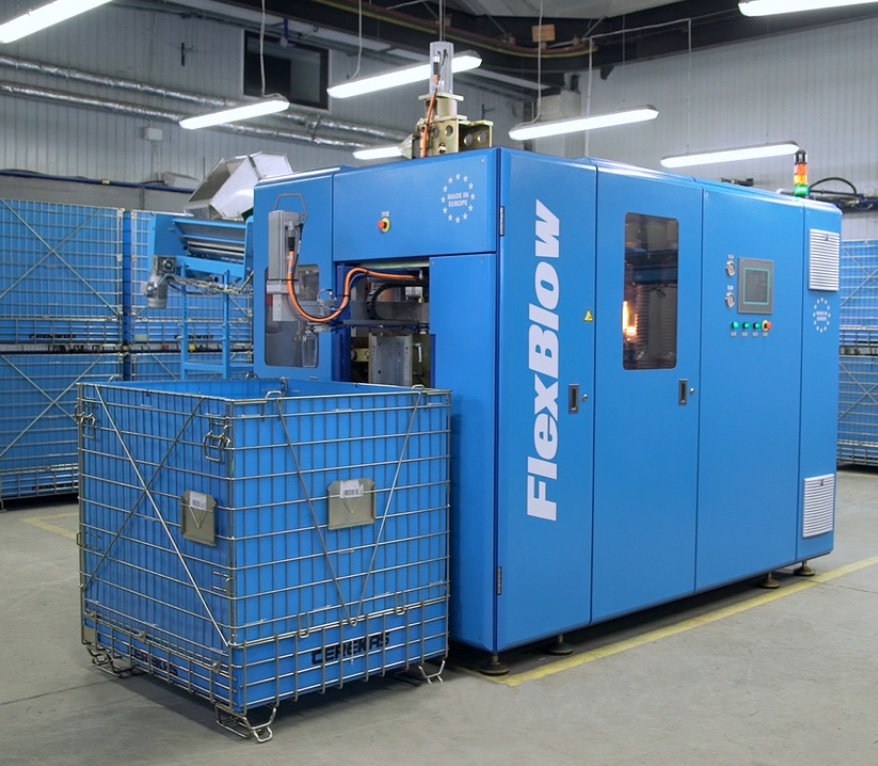

Latest two-cavity FlexBlow2 model SBM system can change over through a range of PET bottles from 50 mL to 6 L in 30 minutes or less.

FlexBlow claims that the latest 2018 two-cavity FlexBlow2 model is by far the most universal 2-stage PET SBM machine on the market. It enables the production of a wide range of PET containers on 1 piece of equipment with necks ranging from 18 mm up to 110 mm and bottle volumes from 50mL up to 6,000mL. Changing the bottle format including molds, neck and gripper parts, and fine-tune the machine afterwards takes no longer than 30 minutes, according to FlexBlow marketing manager G. Sirvinskas.
