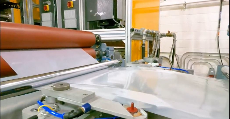

Gibson: VO+ is about accelerating the transition to more sustainable plastics and flexible packaging. It’s an extensively patented cavitation/voiding technology that engineers nano- and micro-scale voids — air pockets — in plastics to reduce density and material use, enhance performance, and improve recyclability. VO+ is effective in thermoplastics including polyolefins and polyesters and in a range of product forms including film, sheet, fiber, and filament. And in case you were wondering, we named our company after the voided structure that VO+ creates in polymers.
Today, VO+ technology is most developed in Machine Direction Orientation (MDO) polyethylene (PE) film. By combining the benefits of MDO with VO+ technology, we address the conflict between material reduction, performance, and recyclability. In that sense, VO+ is a breakthrough that presents a unique proposition for packaging manufacturers and consumer goods companies. It reduces polymer density while improving mechanical properties like puncture and toughness, which in turn allows for films to be down gauged, which offers even more material reduction.
Additionally, when the VO+ voided structure is created, light is diffracted by the film creating high levels of opacity without the need for pigments like TiO2 (titanium dioxide). This is an important benefit because it means that VO+ films can be recycled with clear plastics waste streams without causing color contamination.

Gibson: This depends on the polymer and requirements for the application. In MDO PE films, we typically achieve about a 35% material reduction based on 11% VO+ additive in the final film. Although, we have additive systems in development that could offer up to 50% material reduction.
Beyond material reduction, it’s worth highlighting that a number of our customers are also using VO+ to solve recycling challenges related to very high opacity film. These films often have a density over 1g/cm3 due to high loading levels of TiO2 and this creates a recycling challenge because the film can’t easily be separated during a sink/float recycling process. VO+ films can achieve very high opacity levels while maintaining a density below 0.90g/cm3.

Gibson: VO+ leverages mono and biax orientation technologies to enhance mechanical performance of polyolefins. When films are stretched, the polymer chains align, and this builds mechanical strength. Our tests show that VO+ films typically have equivalent or improved mechanical properties compared to a standard MDO film.
Explain how this technology facilitates recycling from a pigments point of view. I’m guessing this is still store-drop-off or industrial recycling, that is, reintroducing plant scrap into the manufacturing operation?
Gibson: VO+ films are more versatile because opacity is created by film structure, not pigments, meaning they can be recycled in both opaque and low-haze applications. Conversely, traditionally pigmented films are a contaminant in low-haze/transparent recycling streams, and so only have use in white and colored streams, limiting their recyclability. VO+ scrap can also be incorporated back into VO+ films.
A second important benefit is that VO+ films have high opacity levels with low density (below 0.90g/cm3). This means VO+ films can easily be separated during a sink/float recycling process, which is a limitation for some high-opacity films in the market today that have been heavily loaded with TiO2 such that their density approaches or exceeds 1g/cm3.
In terms of films and packaging made with VO+, manufacturers need to evaluate recyclability in the context of the final product. VO+ accounts for a small percentage of the film structure and final product. We expect VO+ to improve, not inhibit, recyclability.
