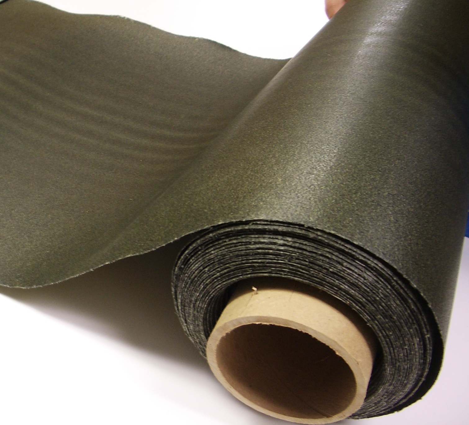

One big issue with the first generation of thermoformed algae plastic was that, well, it looked and smelled like algae.
Ryan Hunt, chief technical officer for Algix, has worked to remove odor from the material and experimenting with colors.
"Algix is experimenting with odor removal techniques because the first generation algae plastic smelled like the ocean," he said. "The samples on display at Pack Expo will demonstrate one of Algix's first attempts at odor removal, which is far superior to the first generation, but still has a way to go."
This time at Pack Expo 2013 the companies will display thermoformed samples of Algix's colored algae plastic.
Slavin said the significance of color in discussions of the value of algae plastic rests solely on the rhetoric of the marketability of the material. Instead of looking and smelling like algae, as in the case with the first generation material, it looks and smells like plastic.
"Moreover, the ability to remove odor and enhance performance while simultaneously offering a variety of colors demonstrates the advances in material science to the consumer, validating the importance of plastics and sustainability in today's market," she said. "It's a unique story that will resonate with today's sustainability minded consumers, and it's cool."
Hunt said that this generation of algae plastic incorporates an additive package that enhances plastic material strength and reduces odor, and it is made with micronized algae biomass, which enhances "dispersion and process-ability."
In other words, through trial and error, Algix discovered that when "mixing" algae with plastic, the algae didn't disperse consistently throughout the base resin; consequently, the material could not be processed consistently. This generation of algae plastic includes processing aids that allow the algae and base resin to blend together more predictably.
In addition, this generation of algae plastic uses algae that has been milled down to a fine powder, allowing processors to control and maintain the particle size throughout production. Taken together - the lubricant additive and micronized algae - allow for a more consistent algae plastic material, suitable for conversion via an array of plastics processing technologies.
Dordan had already demonstrated that the algae plastic can be thermoformed. Hunt said that it's also been converted via: injection molding and extrusion, including cast and blown film.
