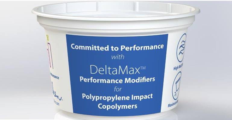

Applications for the food-contact compliant PP resin include large yogurt cups, dip, and deli salad containers.Milliken

Flint Hills Resources’ AP5195-LV PP impact copolymer features a notched Izod impact strength of 1.7 ft lb/inch, melt-flow rate of 100 and stiffness of 212 kpsi, numbers that translate into practical benefits. For example, a high-melt flow rate supports thin-wall designs and increases throughput while reducing energy use. Also, high-impact strength at low temperatures enables refrigerated packaging to withstand accidental drops by consumers or workers. Finally, high stiffness allows packages to be stored, transported, and shelved in taller stacks to conserve space. Competitive materials that excel in one or two of these areas often fall short in the others.
The new FDA-compliant grade can be used for food contact applications including large yogurt cups, dip, and deli salad containers.
Milliken’s performance modifier helps Flint Hills Resources’ new product address strong and increasing consumer demand for improved environmental aspects of packaging. The high melt-flow properties of the AP5195-LV PP impact copolymer allow converters to use less energy in the molding process. Also, the ability to mold thin-wall packaging with excellent strength and stiffness helps reduce the consumption of raw materials.
