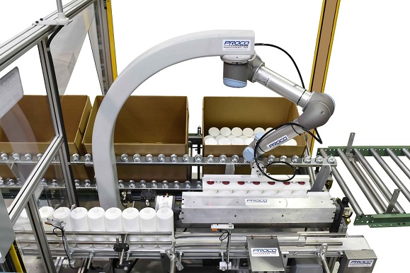

Proco Machinery (Mississauga, Canada) will demonstrate its latest automation technology including the collaborative robotic Half-Cube Palletizer system and the Robo Packer case packer (shown) during NPE2018 May 7-11 at the Orlando County Convention Center in Orlando, FL, Booth # 983.
Proco will also show its Robo Packer case packer (shown at top), a breakthrough collaborative robotic automation system that works interactively with coworkers, requires no special guarding and needs minimal training for teaching new tasks. The Robo Packer is ideally suited for pick and place, assembly and packaging applications at a cost that is 50% less than conventional automation solutions.
The system can be supplied with any one of three different robotic arm payloads depending on the application, the task to be performed, and the level of productivity that is required.
The Robo Packer Basic System is a totally integrated packaging module and is supplied with a six-axis robotic arm, infeed conveyor, and a box conveyor all mounted onto a common sub-frame which in turn is fitted with leveling pads and castor wheels. It can be moved into position, set up, and quickly be in production. The Robo Packer provides maximum flexibility and efficiency and can be configured to pack all necks up or all necks down either using row-by- row or full-layer packing methods. In situations where a standard configuration does not suit a particular application, Proco’s engineering team can develop a custom designed system to provide an efficient, cost-effective solution.
For one of its customers, Proco recently used the Robo Packer in an automation system for production of a wide-mouth canister at a rate of 30 bottles per minute for each line. Proco handled the tighter space challenge, the huge changeover demands, and the need for an 18-pack configuration for each line. The company reduced its labor needs, going from a three-person shift to a one-person shift for both lines at a major cost reduction. The project was a great success and return-on-investment was around 15 months.
