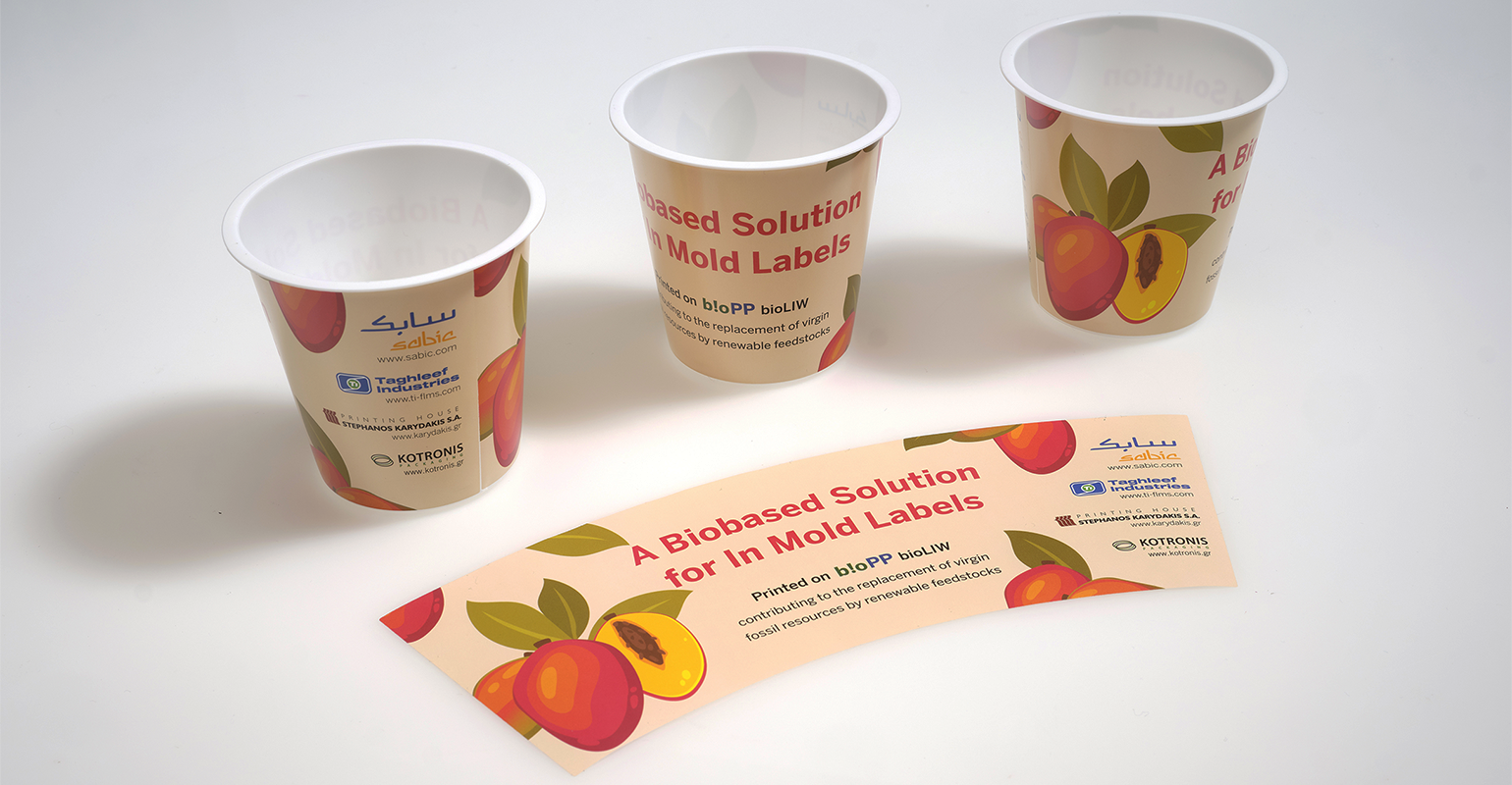

Sabic along with three companies specializing in in-mold labeling (IML) introduce the use of certified renewable polypropylene (PP) resins in high quality mono-PP thin-wall container packaging. And that’s without compromising quality, processability, safety or convenience.
The single-step IML technology achieves a seamless part decoration right in the injection mold, where the label becomes an integral component of the packaging itself. Dedicated label film types and high-definition printing technology result in a very attractive and cost-effective decorative solution. Besides using certified renewable PP resins for both the molded parts and the label film, the resulting packaging can be recycled in existing rigid PP recycling streams.

As part of the present collaboration, the final BOPP label film is supplied to Karydakis, a leading specialist in optimized printing techniques, ink formulations and conversion technologies tailored to PP-based in-mold labels. The company’s sophisticated process delivers high-quality labels pre-printed with captivating designs and branding elements to match end customer specifications and ensure the effortless integration with the containers throughout the molding process.
Bio-based materials available for IML container sizes from 50 mL to 50 Liters.
Giorgos Karydakis, General Manager at Karydakis IML S.A., states: “With this collaborative initiative, we are demonstrating the feasibility of bio-based materials in the production of high-quality IML labels. We offer our customers a wide range of attractive printing options for cups, tubs, jars, shakers, and pails in sizes from 50 mL to 50 Liters, including additional digital watermarking with material information in line with the European HolyGrail 2.0 initiative for smart automated mechanical recycling.”
Augustinos Kotronis, General Manager at Kotronis Packaging, explains: “In-mold labeling offers substantial productivity benefits, since it eliminates the need for separately applied adhesive labels on the finished packaging product by forming a permanent, tamper proof bond with the container right in the mold. In addition, the renewable container material from Sabic complies with all relevant international standards for food-contact applications, while showing excellent processability on our machines, including high flowability for reduced wall thicknesses. Moreover, it meets with our targets for reducing both carbon dioxide emissions and fossil consumption.”
Cut to shape for stacking, the IML labels are finally supplied to Kotronis, a medium-sized family business specializing in injection molded containers for foods. The company facilitates efficient in-mold labeling of cups and tubs in a seamlessly integrated and fully automated, single-step process.
