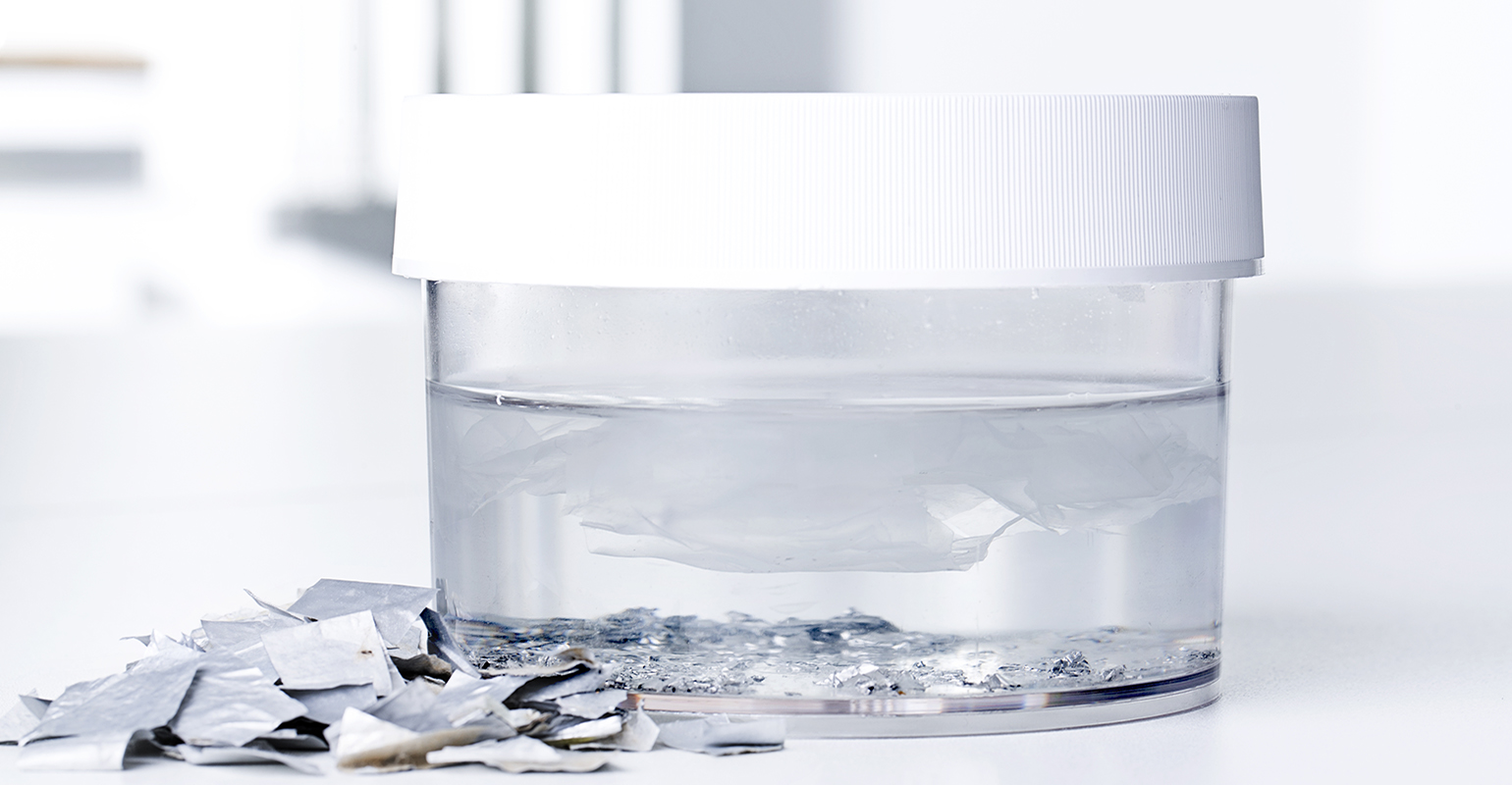

The water-based hot-wash fluids Saperatec uses to delaminate composite packaging are solvent free and used more than 30 times. The method, tested in materials science labs and near-industrial pilot trials, produces materials that can replace virgin raw materials, including in film or foil-based packaging. All chemicals used comply with EU food contact regulations.
“In our first industrial plant, we will produce film-grade low-density polyethylene (LDPE) from post-consumer beverage carton waste as well as post-industrial aluminum-composite packaging waste,” said Thorsten Hornung, CEO of Saperatec. “The film-grade rLDPE is targeted — and currently being tested — for non-contact-sensitive packaging applications. Further development toward contact-sensitive applications is planned.”
By avoiding degradation of plastics, Saperatec’s delamination process sends processed waste plastics downstream “at the same qualities common for mechanical recycling,” he explained. “Hence, recycled polymer qualities are generally comparable while being dependent on the waste input composition. Furthermore, the delamination process is designed to protect aluminum foil from oxidation, so we can recover aluminum as metal content greater than 95% with less than 2% aluminum oxide content.”
