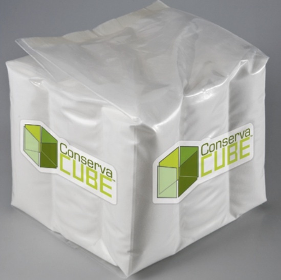

A case in point is customer ConservaCUBE that designed a unique cube-shaped, stackable, stand-up, flexible package for heavy products weighing up to 55 pounds. The customer needed a very durable resin that could meet the needs of this new flexible package—which has up to 15 seals—and still maintain its shape and optics. The resin’s creep performance, a critical attribute for heavy-duty packaging that measures resistance to product deformation, is best-in-class among PE heavy duty sack resins on the market today.
ConservaCUBE chose SPsK919 for its seal properties and strength characteristics and is currently using the resin in commercial flexible packaging for dry mortar mix and pool salt. The resin properties allow these heavy products to stack in shipping and at retail without crushing, tearing or distorting the cube packaging. The durability of the resin enables the package stacked on the bottom to look as great as the one on the top of the stack.
In addition, by partnering with Nova Chemicals and using one of our new, top-quality sealant grade resins, ConservaCUBE was able to move from a mixed-material package to recyclable, all-polyethylene (PE) solution.
