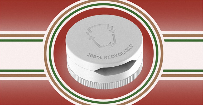

Forsooth! The Bard of Boulder has a few words for thee! Heinz recently announced that it has developed a monomaterial ketchup cap that’s recyclable. Company packaging engineers spent 185,000 hours and $1.2 million figuring out how to remove a flexible silicone valve to ensure that the cap was produced solely from food grade polypropylene.
After 9 years and 45 iterations, the cap is now being rolled out in the UK.
The company’s July 7, 2021, press release, read “The move will mean a potential one billion plastic caps — enough to fill 35 Olympic swimming pools — can be recycled, instead of finding their way into landfill.”
A Fast Company regurgitation of the press release on November 10 showed a picture of the cap. On it there is a recycling symbol in the shape of the famous “Heinz 57” bottle logo. Also embossed on the cap are the words 100% Recyclable*.
Herein lies the rub.
On LinkedIn, I posted that “…in the US, it really doesn't matter what this cap is made of. In general, it is too small to make it over a typical materials recovery facility’s (MRF) recycling screens. It will fall through and join the other bits of material headed for a landfill or waste-to-energy plant.
“Further, this Heinz logo-like symbol would not be legal here in the States. Since the cap is polypropylene, it would have to carry a #5 RIC symbol — a triangle with "PP" in the middle. This is not a highly recycled plastic, and its ability to claim general recyclability fluctuates.”
Also, I just noticed that the words “100% Recyclable” on the cap are followed by an asterisk. But where does it lead? I assume that you would need to scour the front and back bottle labels to find the actual reference. I have a good idea as to what it says, and I’m sure you do, too!

Following an evening of much imbibing and merriment with friends and associates, the answer came to me: Remove the nonactionable, overly cutesy, and misleading messaging from the cap and replace it with the following: LEAVE THIS CAP ON THE BOTTLE WHEN RECYCLING.
Such a simple change! It shall lead to more people doing the right thing. It also helps eliminate the perception that Heinz has simply performed a greenwashing exercise.
