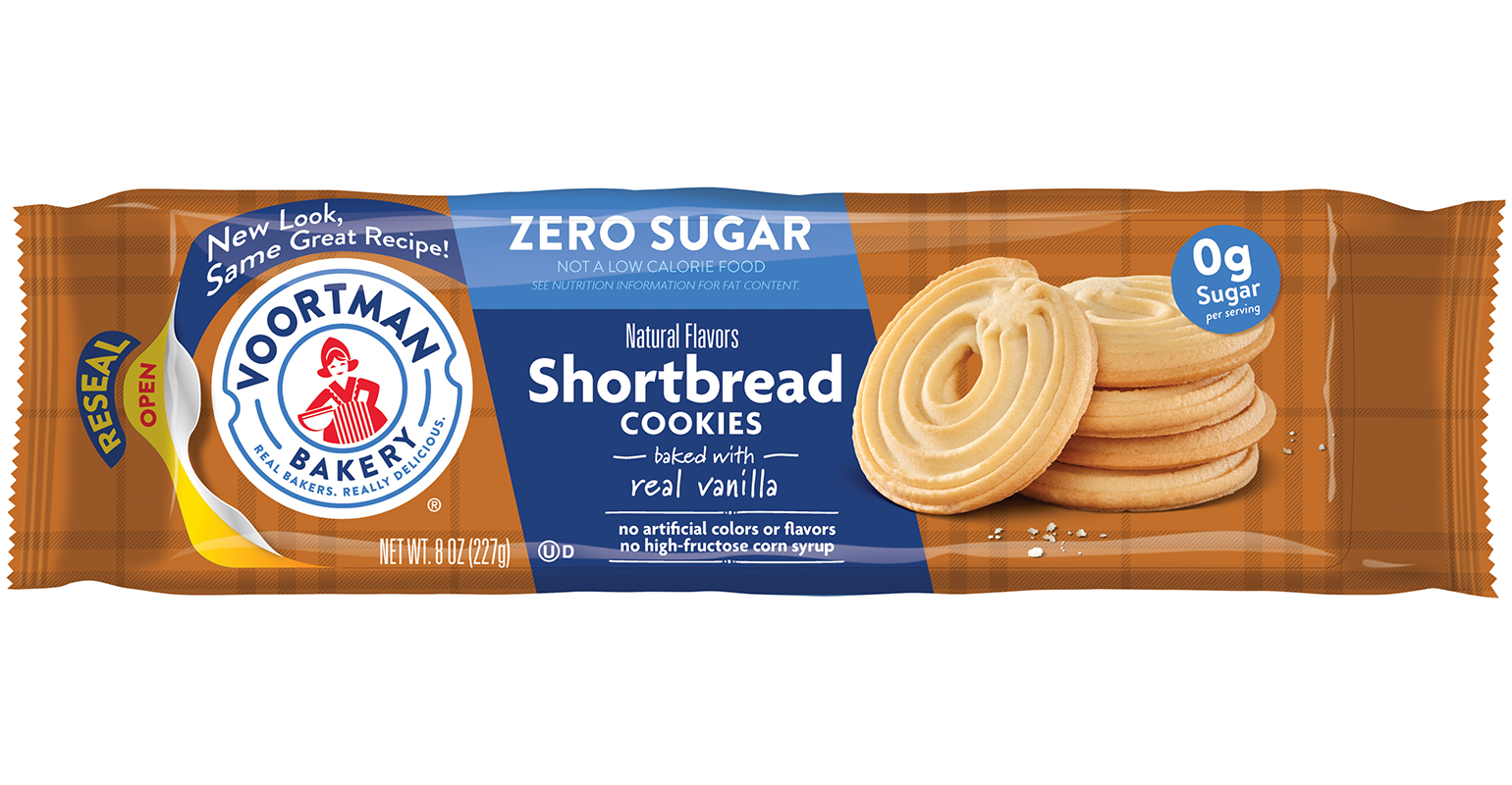

C-P Flexible Packaging provided the technical expertise to make this happen with the extensive industry experience that enabled a streamlined implementation process. At Voortman's packaging production operations in Burlington, ON, Canada., robotic arms fill an inner 3-compartment tray, which is then overwrapped with PET/oriented polypropylene (OPP)-based film embedded with the reseal feature. The resealable package incorporates two “bridges” aligned precisely with the tray compartment ridges.

Bridging the resealable packaging gap.
The inherently tight and narrow long package profile meant the package "bowed outward" in width once a standard reseal feature was used. The tight package profile was preferred for brand image and due to Production constraints. This meant bridges were required to ensure the reseal feature would function properly.
In the final package, two “bridges” span across the width of the package. The size of the bridges was dictated by cookie size and the limited width available for resealing along the sides of the opening.
"Cookie dimensions were critical in refining the reseal opening required to accommodate two larger size cookies as well as a dozen more standard size cookie varieties and ensure alignment of the bridges with the inner tray," reflects Babony.
This meant the bridge size decreased as the project progressed.
According to Manchester, "As the bridge size decreased to accommodate larger cookies, bridge tearing concerns were addressed by switching to a structure containing PET and modifying the level and location of an adhesive deadener on the bridges to inhibit bridge tearing. Moreover, we were able to use the smaller width bridge to accommodate all cookie sizes.”
“Interestingly, the bridges allow for portion control because consumers open the package section by section,” adds Babony. “Our predictive shelf-life tool allowed us to know that this material structure would not impact product shelf life.”
