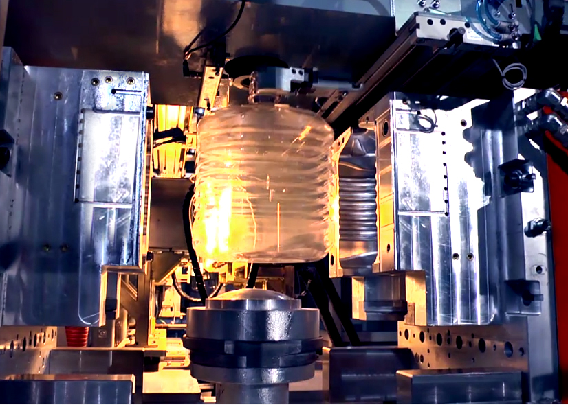

However, it’s not that easy. Bottles often breakdown in a lopsided fashion, leaving lots of space inside even when they are completely empty of water. So, PET packaging technology producer Sipa (Vittorio Veneto, Italy) has been collaborating with various customers into developing designs for large PET dispenser bottles that are fit for purpose in transport and use, and which collapse on themselves as neatly as possible as the water levels go down.
Collapsing trials were simulated on computer using Finite Element Method (FEM) analysis to locate the buckling mechanism that would best suit the client’s requirement. “FEM analysis accelerates the time of investigation and reduces the number of trials aiming at the correct solution,” says Dino Zanette at Sipa. “It also aids in determining a minimum weight at which the collapsing mechanism is still functional.
Various bottle shapes, square and round, were analyzed along with the shape of the ribs and base. Graphs of volume vs. pressure and base center displacement vs. pressure, together with photograms of the simulation, helped the Sipa experts to better understand the collapsing phenomena and how to modify the bottle structure to get the best performance. Physical prototypes were constructed to verify the “virtual” results.
Trials have proven the reproducibility of the collapsing mechanism that was examined during the development stages. So now, fully self-collapsible containers that require the application of no external mechanical forces to deflate are currently in industrial production. This makes the job of collecting them for recycling or simply putting them in a recycling bin much easier than before.
