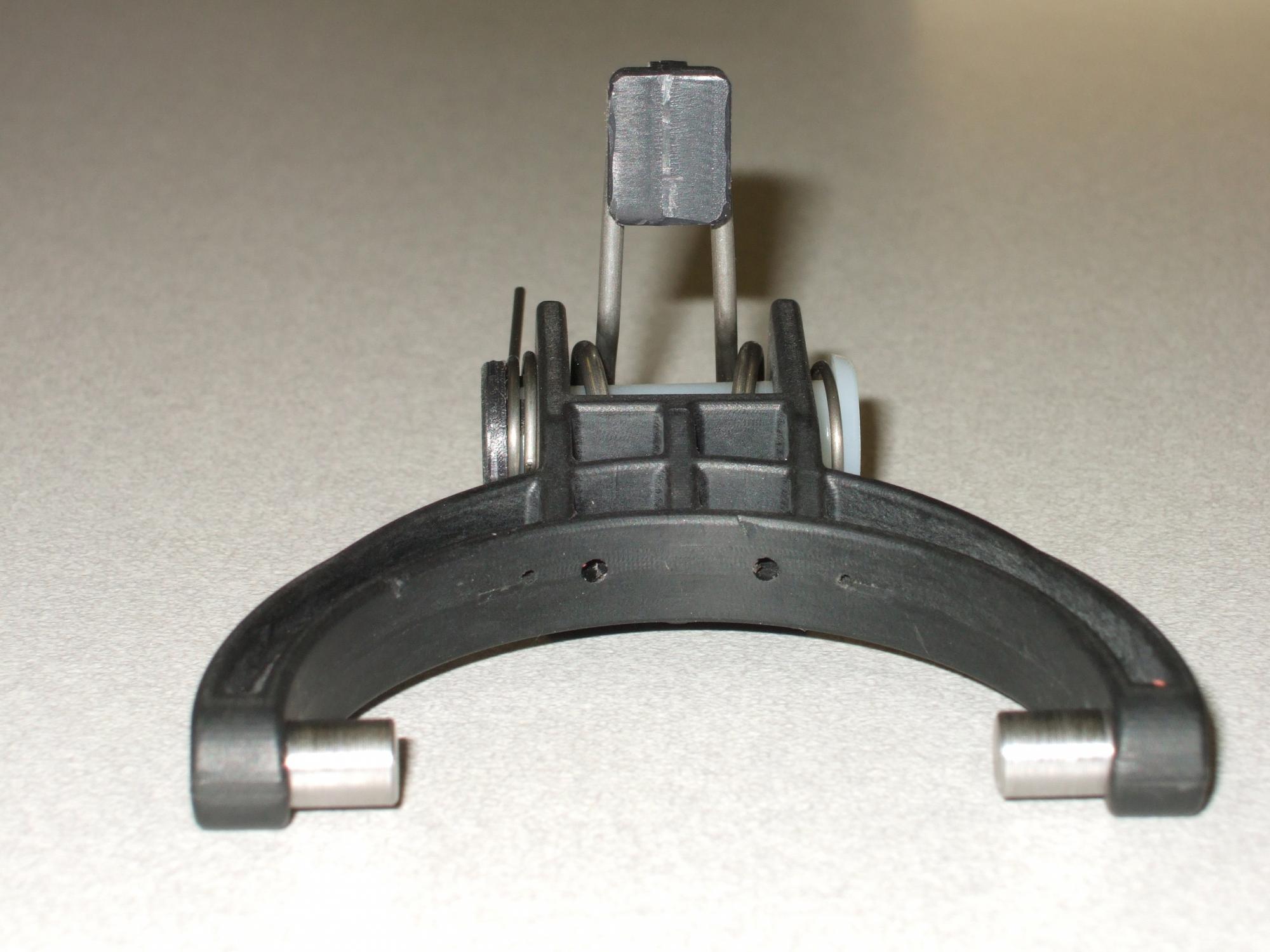

'Before' picture of a Shift Fork - an automotive metal part. |
The 'after' is the plastic part |
