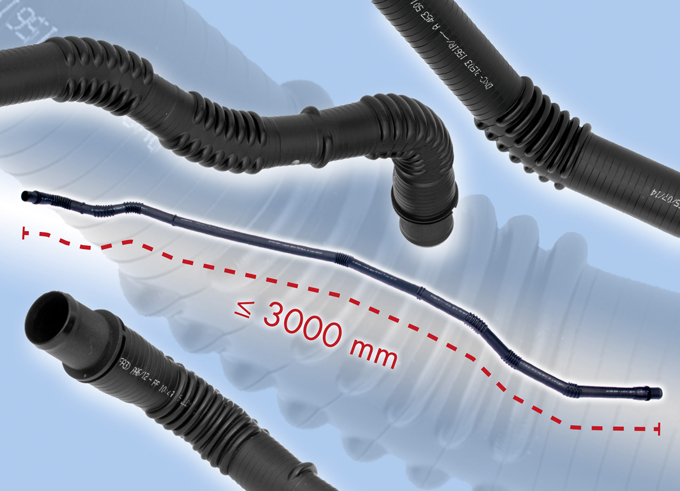

Tristone Flowtech Group was looking for a material and technology for an unusually long 2- to 3-m variable flexibility coolant pipe to transport water and glycol fluid from the radiator end tank to the engine at the back, while saving weight. The challenge was not so much the length of the part, since it was extruded, but producing large pipes in diameters measuring up to 27 mm, structured in two layers with convoluted sections, that would resist 3 bar pressure, aggressive fluids, and road salt.
DuPont provided the solution via a combination of Zytel PA612 LCPA and its patented Variable Stiffness Bellows (VSB) technology, enabling flexibility and pressure resistance in thermoplastic parts. The new pipe can withstand engine compartment temperatures of 150°C, aggressive fluid temperatures up to 120°C combined with road salt, and continuous working temperatures of 95°C. In this application, Zytel PA612 in a corrugated extrusion offers a lightweight alternative to metal, enabling up to 60% weight reduction over the former aluminum component.
